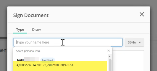

I've seen a few similar posts to this but don't see a clear answer. We've had an issue pop up where a manager is signing a form, and the Edge browser's autocomplete is not only filling in his name for the signature field, but also changing some amounts further up on the form (highlighted numbers in the screenshot below). Worse, these are above the part of the form that is visible so it's not at all obvious to the user.
I need to get this disabled so managers aren't inadvertently changing amounts to whatever it was when the browser saved their typed name in the signature field.

@████████ have you encountered this? I think it's part of the new Microsoft Wallet functionality in Edge.
I managed to recreate the issue. It saves automatically without prompting and I can't even see the saved data in the wallet.

I think this will work, at least for this particular case. For each form in the process I added the JS
$('input[type="text"]').attr('aria-autocomplete', 'none');
It's all testing just fine so I'll add it to production this week. I thought the JS might prevent some of the lookup autocompletes, but those all continued to function properly.
Hopefully the issue is limited to this process, but I fear it won't be. That new Wallet functionality in Edge is very aggressive about storing and auto filling and it stores silently. I fear for what happens if this causes issues with forms built in the New Designer in v11, where JS like that won't function.
