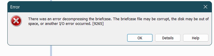

There was an error decompressing the briefcase. The briefcase file may be corrupt, the disk may be out of space, or another I/O error occurred. [9265]

and got error for some of one
------------ Technical Details: ------------
LFCommonDialogs110.dll (11.0.2102.83):
    Call Stack: (Current)
        CBriefcaseImporter::ImportBriefcase
        CImport::ImportBriefcase
    Call History:
          GetDatabaseDisplayName
          ChangeNumberHelper::GetObjectW
          ChangeNumberHelper::CacheObject
          WriteOptionString ([Settings]BriefcaseVolume)
           SetProfileValue
            AddProfile
             UpdateProfile
