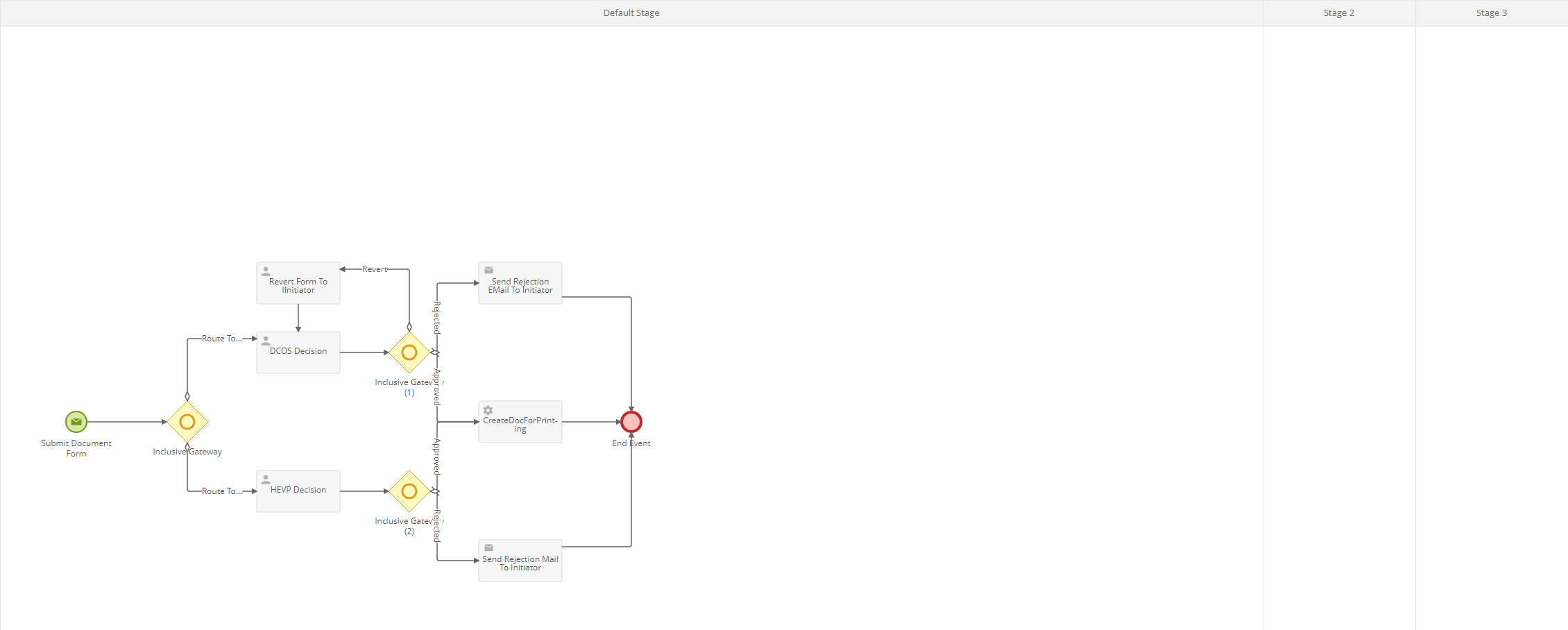

Hello Everyone, Please I need urgent help on this one. I have a fairly simple scenario. I have a form that is used to create a document for printing. That Form is sent to either of two people depending on who is selected. Whoever of the two approvers, can approve, Reject or revert the form for further corrections. When it is approved, a workflow Tasks initiates a workflow which creates the document and send for printing.
I have done the Approve and Reject bit and it is working. My challenge is
1. how to route back the form to the submitter/Initiator for corrections and resubmission of the form for approval when the Revert button is selected. Does it go back to the initial gateway where you choose who is to approve and then you pick the Approver again or how to send to the initial approver who reverted the form.
2. When the reverted form is approved, how do i connect to the Service Task that creates the final document for printing.? Do i have to create a fresh Workflow Service Task for the printing or connect to the existing one.

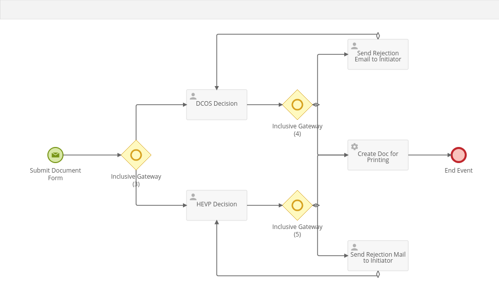

My Model diagram is below
Am using LF 11 On Premise.
A stepwise guide will be deeply appreciated.
Thanks

replied on June 4, 2024
If I'm reading your process diagram correctly, instead of routing "Send Rejection Email to Initiator" to "End Event", I would loop it back to "DCOS Decision" or "HEVP Decision" based on a variable (ex. the field used to decide who it routed to the first time, or the field showing the user who rejected it).
If you change the Email Service Tasks to User Tasks, you can click "Email users when this task is assigned or reassigned", then they will still get an email alert, but they will also need to re-complete the form before it is sent back for approval.

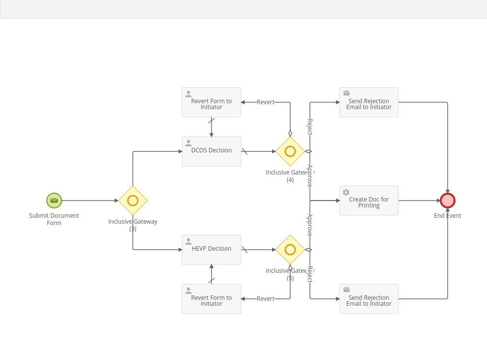

I just mocked this up quickly to show what I'm meaning, maybe this will work for you?
Let me know if you need me to rephrase anything or try to explain a little better what I'm meaning and I'll do my best to help.

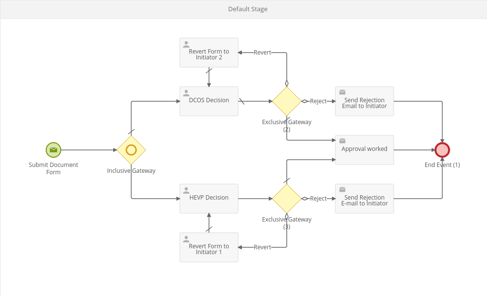

Sorry, just re-read and noticed you have Approve, Reject and Revert. Maybe something like this would be better?

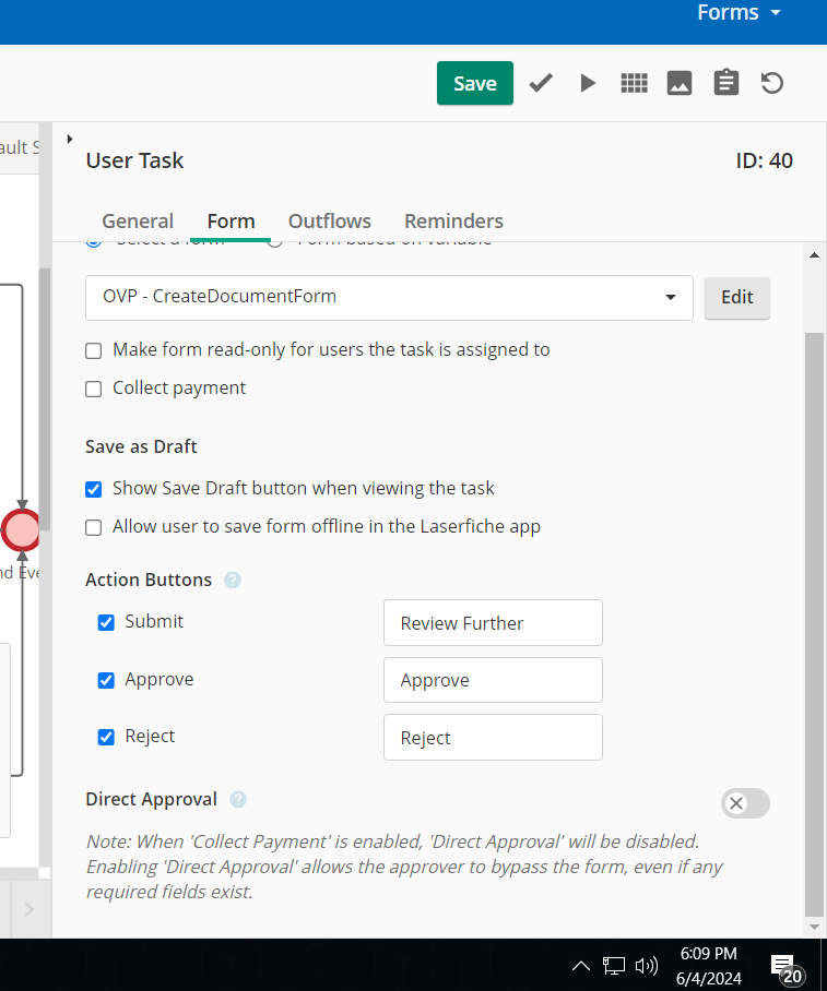

2. For The properties pane of  the Revert to Initiator User Task, Do i need to include the Submit(Revert), Approve and Reject Button in the Forms Tab?
3. Can you guide on what to set up for the Outflows Tab or i could just leave  it as it is?
Hello Sarah,
I just tried the new process based on your model. But i find that when the form is reverted and DCOS approves, it goes back to initiator again, and again. It does not seem to recognise the Approve and rout appropriately.
What could be wrong?
Would you mind sharing another photo of your diagram so I can have a peek? It could be a number of things. Do you have any of the outflows marked as default?
For the properties pane of the Revert to Initiator User Task, I would just have Submit. (Although from your screenshot it looks like you're using Submit as your Revert button, so that could be causing the loop..)
In Cloud there is the option to add more action buttons, it's strange that wouldn't be a feature for On Prem.
Is there a reason to have rejections terminate the process, or would it be possible to use Reject as Revert, and keep Submit as Submit?
As I'm getting further through my coffee I'm realizing it might be your gateway. I believe you should be using exclusive gateways in the second half of your process, not inclusive.
Exclusive split = either/or
Inclusive split = and/or
If adjusting your action buttons doesn't stop the loop, I'd try switching those out and see if that fixes the issue!
Thanks Sarah.
For the Outflows, I have the approve and Reject set as default path but not for the revert button.
Also, when I initially used Exclusive Gateway for teh second part of the process, the process didnt work until i changed to inclusive.

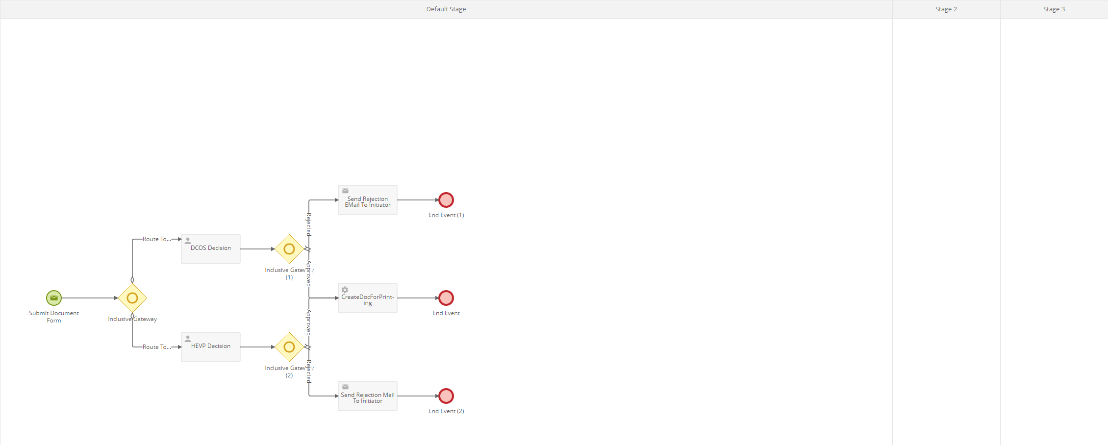

Below is my original model.
You should be using conditions for the outflows, you should not have multiple default paths, that has the potential to cause a loop as well.
Can you share a photo of the current diagram, that you said is looping back to the initiator over and over?
replied on June 4, 2024 Show version history
@████████I have this working correctly on my end using exclusive gateways for the second half.
Revert and Reject pathways use conditions (Last user task = X), and Approve is set as my default.
@Sarah, obvisously there is significant modification based on the new model you just shared. So I am going to remodel based on it.  Thank you so much much. I will revert on how that goes. Meanwhile this is the one that was loopiing....

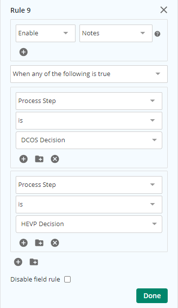

If you still want a comments section, I would recommend adding a multi-line field so you can store the variable information from there. You can also add field rules to enable/disable the multi-line field when process step is/is not "X", so only the approver is able to fill in comments.

Do you have these options for field rules? I'm not sure if maybe I have more options being on Cloud? "Notes" would be whichever variable you are using for your multi-line comments field.
replied on June 5, 2024
@Sarah, actually you have more variable options being on cloud. Am on OnPrem. There is no process step option in the field rules.

Actually, you can use Process Step and Process Stage with On Prem.  I think it may have come with Forms 11 Update 3.  You need to be using the Modern Designer.
