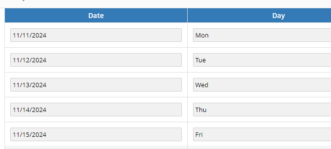

Anyone have a tip for setting a column to a set number of px?
These look ridiculous ha ha:
I have been going round & round with CSS trying to adjust it, but it appears that it is taking my CSS and classifying it a certain way that doesn't reach the actual form:
Anyone figure a way to 'lock' the width of a column? I have tried using bootstrap in the css as well to no avail.
Thank you very much in advance :)

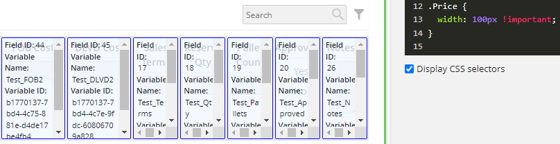

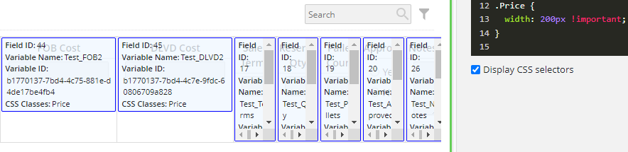

replied on June 3, 2024
It's entirely possible to resize table columns with CSS. Here's my coding showing it working:
100px:
200px:

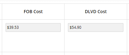

@████████It works on the actual form, as well as the form when saved to the repository. My use was to set a min-width so pricing columns didn't overflow into multiple rows, but the opposite should work the same.

I just double checked that it was showing on the form itself with the coding I screenshotted, and it wasn't, but adjusting it to min-width: 200px instead of width: 200px worked. I tested with max-width: 20px and that worked as well. Hopefully you can get it working on your end!

Just to show I'm not crazy..
Max width 20px:
Min width 200px:

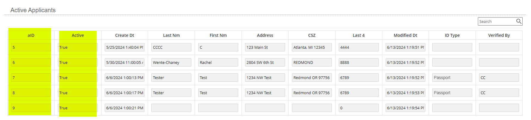

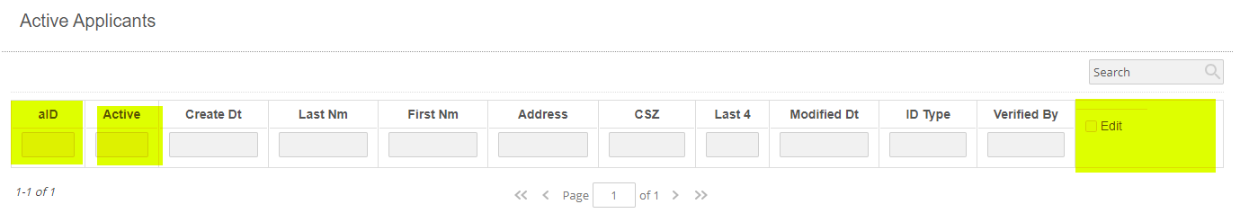

Zac, my problem is that I have a very narrow column with 1 or 2 digits in it and uses 3 or 4 times as much space as I need. So I want to lock them to specific width. The sliders seem to only allow a % that adjusts with the screen size. I see the value in that for adaptability, but that isn't my case here. My biggest problem is that the sliders are not effective after a certain number of columns exist:
Highlighted sections are as small as I can get them:
This translates to (checkbox on far right hidden):
I'd like to give the name and address fields a wider size ideally. Also the format is wonky with the aID column being so wide.
I did make a run at using CSS to lock the width on the column and header but have failed there. If you can tell me the best way to do that, or if you have any better suggestions, I'd be really greatfull :)
Thanks so much!

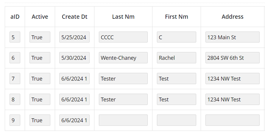

replied on June 13, 2024
I think it does make sense to provide an override for width in the advanced pane of field settings. Something that accepts precents or other units like px/rem/em. At somepoint I do want to spec out more support for grid classes so you can handle medium/large breakpoints on your own without CSS but I seem to be the only one that needs that haha.
Anyway, the following CSS seems to work for me. Not a fan of needing all of the !important flags, but its the only way to override inline styles on the html elements. Add the custom-table class to your table so you dont break all the other tables on your form. The first two rules will fix all columns to be auto by default, and then the subsequent rules are for the individual column sizes. Make sure you are targeting the correct columns in the nth-child selector and copy that for each column you need to not be auto. It doesn't work in the designer view but that is probably a good thing as small columns are hard to work with there.
/* make all columns auto-size by default */
.custom-table table colgroup > col {
  width: auto !important;
/* remove all static widths from table cells */
.custom-table table td {
  width: unset !important;
/* add specific column widths where needed */
.custom-table table colgroup > col:nth-child(1) {
  width: 10% !important;
.custom-table table colgroup > col:nth-child(2) {
  width: 50% !important;
7 0
replied on June 14, 2024
You're the best! This was exactly what I needed. I saw the colgroups in the html and tried to manually change them but didn't get any results so I moved on. My OCD is happy now :)

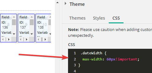

Try changing
width: 83px !important;
to:
max-width: 83px !important;
See if that works for you. Fingers crossed!
You should only need:
.YourClassName {

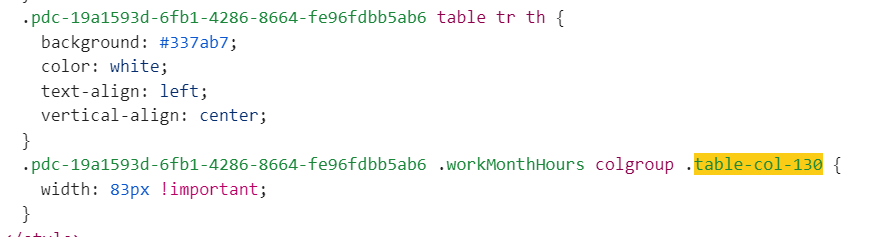

Ah that didn't work. I'll post the things I've tried so far for reference:
.workMonthHours table-col-130 {
.workMonthHours table thead tr .fl-table.fl-component th.table-header-cell:first-child
  width: 83px!important;
replied on June 3, 2024 • Show version history
Instead of
Try:
#q1 {   (Replacing 1 with the field number for the column you are trying to select)
Edit: Ignore this one, I could have sworn I'd used it in the past but it's not working for me now.
Is there a reason you're trying to use multiple selectors? Could you create a new CSS class that only targets those two fields and use that?
For example if you just use this, it should work for you:
.workMonthHours {
Ya, putting the width on the specific cell is where I started, then I slowly became more & more specific.
Still, without adjusting the column header, it won't matter what I set the individual input field to. So, I have been focusing on this element where .workMonthHours is the class on the table itself:
.workMonthHours table thead tr  th:first-child
I'm just not certain this is even possible any more in the modern designer...
0 1
It's possible, I'm currently doing it on one of my tables.
What you need to do is set a custom CSS class for the field (header) you are wanting to target, and use that CSS class in the code specified above. You don't need to target the header itself, just the CSS class for the field that the header represents. If that makes any sense at all.
In short, try being a bit less specific and see if you can get that working.
Let me know if I'm not making sense and I'll try to rephrase!
1 1
Sarah, are you using the modern designer (no classic designer)?
I tried doing just what you suggested but no luck :)
