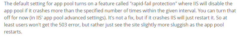

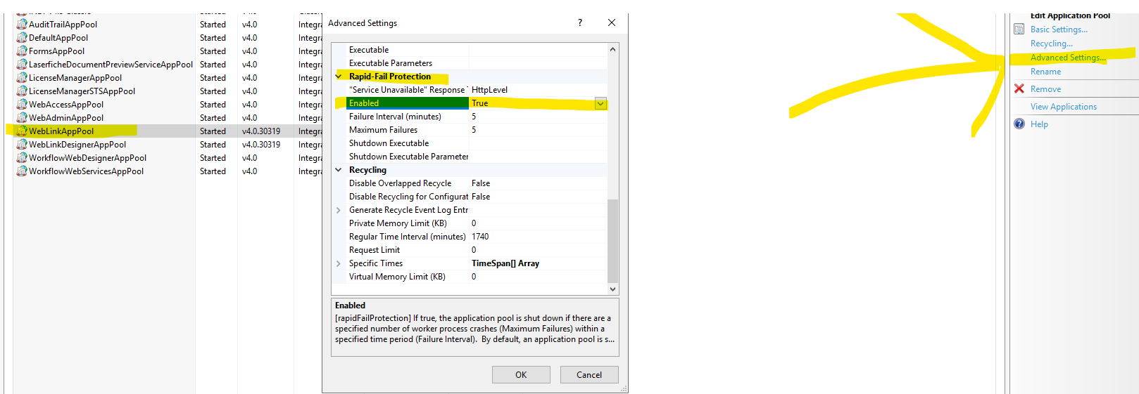

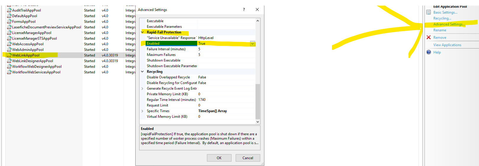

I have a client that is also experiencing the same issue since May 16th. They are running version 11.0.2303.1404.
In the meantime I've advised them to "disable" the 'rapid-fail protection' to keep it running.
The screenshot shows the default setting of enabled = true. You would set that to false.
Hopefully Laserfiche can come out with a resolution for this.
