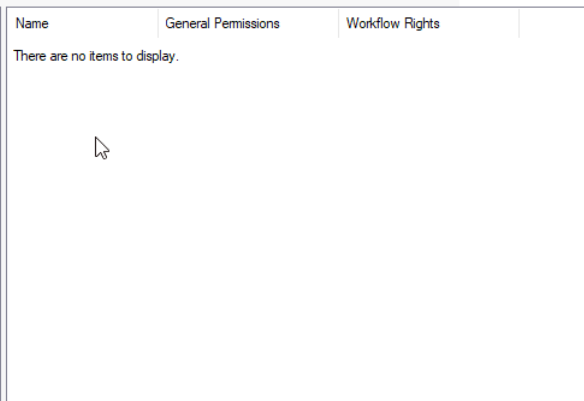

Recover permissions to access WF?
asked on May 22, 2024
If all users get removed from the WF permissions and rights page, is there any way to recover access without a re-install?

replied on May 22, 2024
They were not removed from WF, rather the account(s) that were in there are gone after a domain change, they just cease to exist. I only have an account on the new domain now, so I would need some way to add my new domain account back in. Do I need to manually do this in the database?

replied on May 23, 2024
It does not let me add using the WF Administration console. There are windows groups for DS and Audit Trail but I don't see one for WF.
