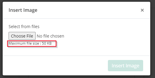

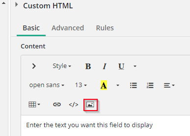

Client needs to upload an image to be displayed in a form as part of Custom HTML.
User wants to upload a file larger than 50kb.
Is there any way to increase this limit or is it a hard limit?
