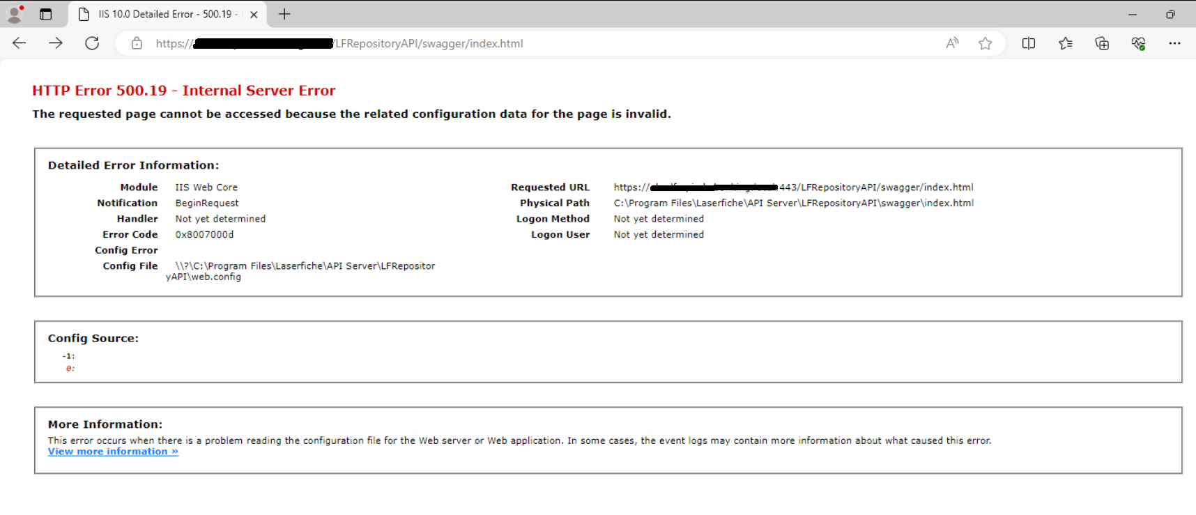

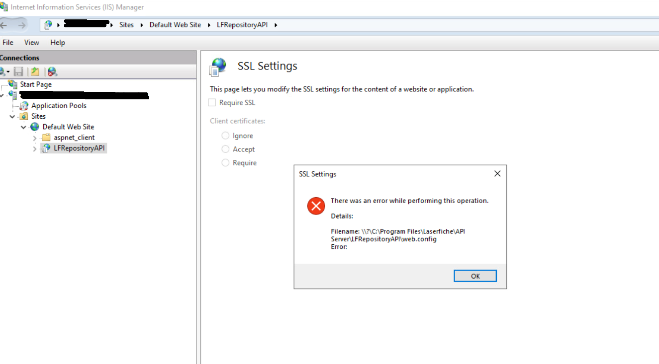

Hi,
While installing Laserfiche API to a client, I cannot access the API page due to these errors warning below.
The client do not have Laserfiche Web Access. They only have Laserfiche Client. Can anyone try to fix this issue please?

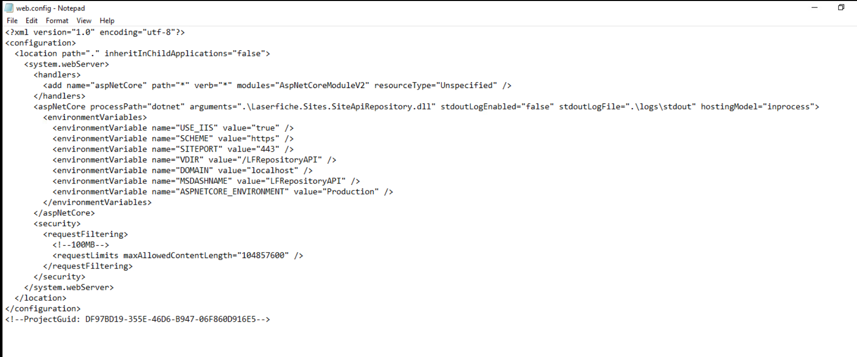

I'm not too familiar with Laserfiche API specifically, but when IIS complains about the web.config file and is unable to point to the particular line it's usually a permission problem reading the file. I'd suggest opening the file in notepad to make sure it appears correct, and then making sure that the account you have set for the application pool has read rights to it. There may be more information in the event viewer.
replied on May 20, 2024

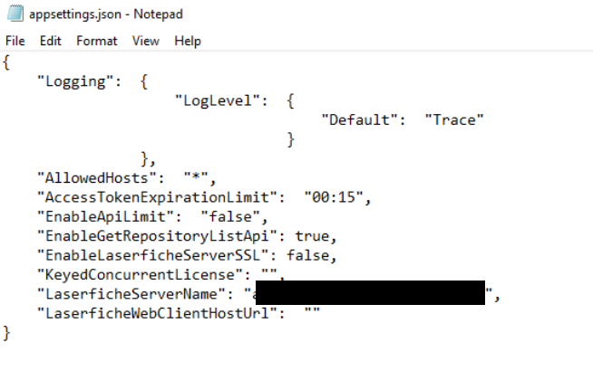

I have inserted 2 more files above to verify and if there is any amendments to do

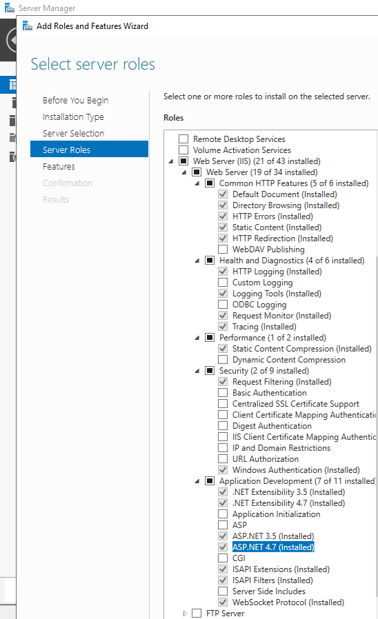

You may be missing a prerequisite: .NET 6.0 ASP.NET Core Runtime.  Try installing the "Hosting Bundle" which includes the .NET Runtime and IIS support.
I have already done that
I have also added the other 2 json file
replied on May 21, 2024
Web.config and appsettings.json look fine. Is IIS ASP.NET 4.x installed?
Yes it is checked
replied on May 22, 2024
I did some googling: try to repair "Hosting Bundle", reinstall Laserfiche API. Do other web app work in that IIS. "permission problem reading the file" is still a possibility.
