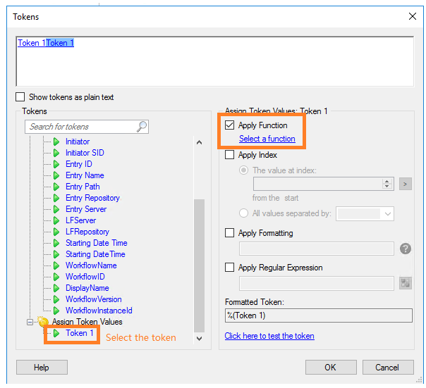

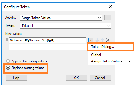

How about using Assign Token Values activity? Modify the existing list token, choose Replace existing values, and then choose the Token Dialog
Then select the token, choose Apply Function, to select a function

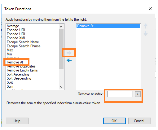

Use the Remove At function, and specify the index you want to remove. The index could be specified with a token.
If you want to remove multiple values from the list, you could insert multiple Remove At functions. Here you need to remove the items reversely, like delete 5th value first, and then 3rd value, finally 1st value, which is similar to the following.
If you want to remove the values that matching the specified text from the multi-value token, please try the function Remove.

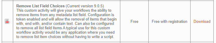

replied on May 21, 2024
Qfiche has a custom workflow activity that might work for you.
