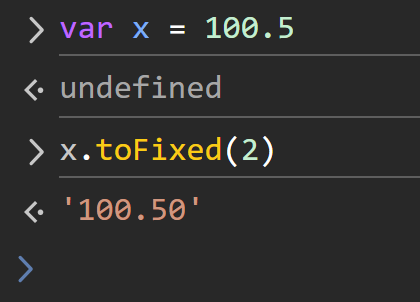

If the value is numeric CurrencyField.toFixed(2) alone should be sufficient.
The reason for this behavior is that Currency is a "masked" field, meaning it stores a numeric value behind the scenes so they can be evaluated numerically in calculations, gateway conditions, etc.
However, the value is displayed as formatted text because leading/trailing zeros, commas, etc., are not valid for true numeric types.
100.5 and 1000.5 = numeric
'100.50' and '1,000.50' = text/string

I was able to resolve this by adding the following:
(Math.round(CurrencyField * 100) / 100).toFixed(2);

I don't think you need the rounding step since the math just cancels out.
