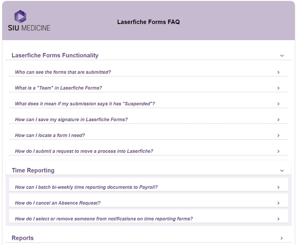

Here's our use case:
We're creating a "Laserfiche Forms FAQ" process using nested collapsed sections.
When we played with doing this previously, it was prior to the Modern Designer, and @████████ added a search bar to the form (it was lovely).
We are now building the form using the Modern Designer, and we asked him to see if he could create the same or similar functionality.
Screenshot included to give you an idea of what we're thinking.

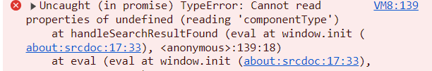

Thanks again for your help on this. I tested a few search queries and it did filter a few various queries but certain words triggered an error (see attached) ; things like 'form' or 'team' returned that error but there are probably others. Also, it would be great if it expanded the section if it was in an expandable/collapsible section and toggled it back to be collapsed if search query did not match. There was one other issue as well, such as it not highlighting div.section-titles.
It currently only searches custom html and section titles/text above/text below. You "should" be able to update the searchOptions object with other search criteria. (I dont see you attatchment)
Support for HTML highlighting in field labels and other settings is only supported in cloud at this time. Are you on cloud or self hosted?
Sorry, I attached it. We are on self-hosted.
I fixed it by just checking first whether a parent exists before filtering down and that takes care of it from what I could tell..the only thing I still need to address is actually expanding the sections when a match is found in a collapsible section so I am still working on figuring that out. Do you know if highlighting section headers is in the works for self-hosted?
Ah, ok I must have missed a place where i map componentId to fieldId.
