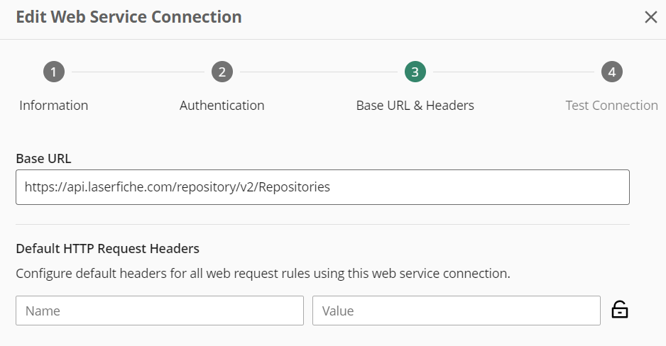

heres your next step of the web service connection:

In the developer console > applications > <your service application>, go to the authentication tab, click create key, then "Create a long-lasting 'Authorization Key' secret used to obtain Laserfiche API Access Tokens".
The in 'Integrations' in your 'web service connection', here are your settings. (This is minimally documented!). And you can change your scope as necessary. I swear that repository.ReadWrite worked at one point but I think you need to list them separately (repository.Read repository.Write).
And make sure your authorization starts with "Bearer" and then a space, then your auth token. The auth token is the token from above "long lasting..."

replied on June 19, 2024
Hi Anthony - thanks so much for this, i think we can follow it from here but look forward to the video content.
replied on June 21, 2024
This is working, thanks for the help.
