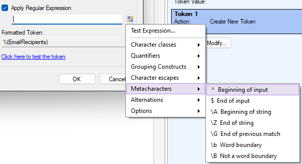

Creating your regex using the token editor answers this for you. As Travis showed, you should be using "^" to signify the beginning of the input instead of "/", and using "$" to signify the end of the input instead of "/i".
