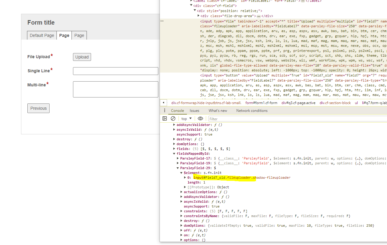

The File upload field is a little complicated as it contains a hidden <input type="file"> element and a visible <input type="button">element. In your script, you are actually validating those fields that are not hidden here $("#form1").parsley({excluded:":hidden"}).
When you simply run $("#form1").parsley({excluded:":hidden"}) in the console, you'll see the fields that's being validated don't include the hidden <input type="file"> element, but just the visible button. For example,
Thus I think you may need extra lines to validate the file upload fields specifically, something like
$('.file-drop-area').parent().find('input[type=file]').each(function(i, ele){
$(ele).parsley().validate();
