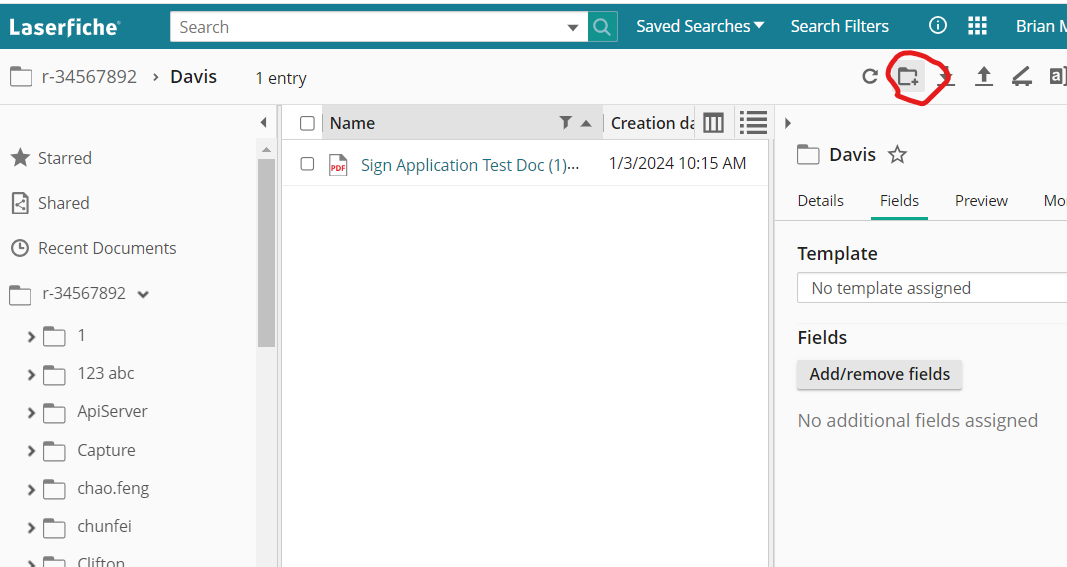

Just to make sure we're on the same page, clicking this button will bring up a dialog to create a new folder.
The dialog only prompts for a name, not a location, so if you want the folder to be somewhere else you have to first navigate to that location.

This is what I see when I go into Records. So it seems obvious to me that creating a new folder will fall under Employee-Records. Just to be clear on my part, I simply want to create a new folder NEXT to Employee Records. It should not go inside Employee Records and Employee Records shouldn't be a subset of it. When I go into this site the only options I get...
...all pertain to the Employee Records folder. I would think Options or Management would be outside of this folder, but I haven't found out how to get there!
replied on April 4, 2024
"Employee-Records" is the root folder of your repository, it's not possible to create anything outside of it. You can think of it like "C:\" - if you create a folder on the drive, it has to go under there somewhere. And similarly it's not impossible to have a "D:\" that would in a sense be another top level - but just as adding another drive to a machine isn't the solution to every problem, creating another repository comes with benefits and drawbacks.
I hope that makes sense. Maybe if you can say more about the problem you are trying to solve we can offer alternative solutions.

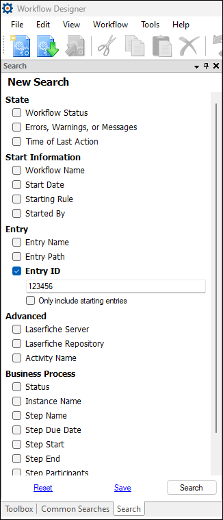

replied on April 3, 2024 Show version history
Are you saying you create the folder in one location, and it moves to another?
That could make sense if your organization wanted to ensure everything a user created was moved into a dedicated location.
If that is the case, then you likely have a Workflow running that does that.  It could be monitoring for the creation of documents or folders in certain locations (or repository-wide even), and then following several steps to determine who the creator was and move the item to that creator's personal folder.  If that is the case, then you might need to look at how the Workflow is set-up to determine how best to prevent it from running in this case (maybe just disabling the starting rule temporarily, or setting up some exceptions to the starting rule).
EDIT TO ADD: If you are uncertain about the possibility of a Workflow, you could find the Entry ID of the folder you just created (right-click > Properties) and then search in the Workflow Designer for workflows that recently ran on that particular Entry ID.  Like this:

So that you know, Laserfiche Workflow is an automation tool that can impact documents within the Laserfiche Server/Repository environment and communicate with other systems and databases.  The Workflow Designer is the program that you use to set up those automation processes (workflows).  The Laserfiche Client is a different tool which allows you to navigate through and work with the documents within the Laserfiche Server/Repository environment.  The screenshot you shared in your other comment (replying to Bryan) is from the Laserfiche Client (specifically the Web Client, which is browser-based as opposed to the Windows Client that is a stand-alone software tool).
