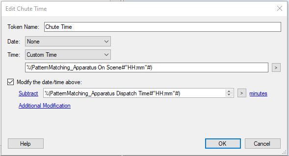

I have a workflow that reads a document and pulls a variety of times. I need to calculate the difference between the times, so I used the Date Token Calculator.

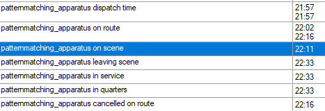

The data is pulling properly (I don't need the seconds.)
Here is my calculation.
FYI, I did try adding the seconds to the time, but it made no difference, so i changed it back.
Here is the error when I run the workflow.
I have tried a variety of things, but have not been able to track the reason why this is happening or how to fix it. I went through several posts on Answers, but to no avail. Please help.

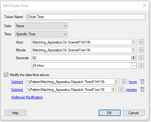

I tried to convert as recommended, but I kept running into issues where the time overlapped from one day to another. I'm sure this would work, but would involve a few more calculations.
As I was playing with the process, I ended up deciding to change the Time from Custom to Specific. Between that and using multiple calculations in the Adjustments area, I was able to get it working.
If looks like this:
replied on April 2, 2024
That's because it's looking for a number value in minutes, not a time value. You'd probably need to do some math in your workflow to figure out the time difference between on scene and dispatch:
  • Convert the hour difference to minutes and add it to the difference between the on scene minute and the dispatch minute.
For your shown example, dispatch 21:57 and on scene 22:11:
  • 22 hrs - 21 hrs =  1 hr * 60 min/hr = 60 min
  • 11 mins - 57 mins = -46 mins
  • 60 min + -46 mins = 14 mins
Calculating it this way would give you a number you can use for your time token calculator, no matter how large the difference is.
replied on April 3, 2024 • Show version history
Thank you for your suggestion.
If looks like this:
