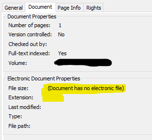

The issue you may be having is that TIFF is the native format for pages in a Laserfiche document, but the Extension property is for Electronic Documents attached to the Laserfiche entry.
Something like a docx, xlsx, or pdf document would have the corresponding file extension for that electronic document.
However, a document with TIFF pages is the native format and would not have an extension set unless there was a separate electronic document attached.
That being said, it really depends on how the documents were imported in the first place because if they were imported with the wrong file extension that could've prevented it from generating the pages properly.
Native Document with TIFF pages
Electronic Document

You should be able to "Generate Pages" through the Desktop Client, and then remove the electronic file.
