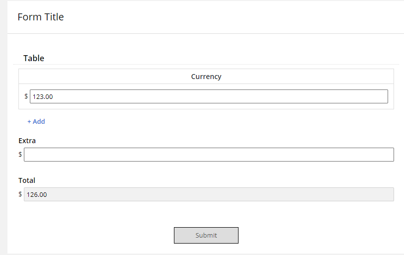

For the screenshot below, I entered $123 in the table and $3 in the Extra field. That totaled to $126. Then deleting the Extra value of $3 does not update the total.

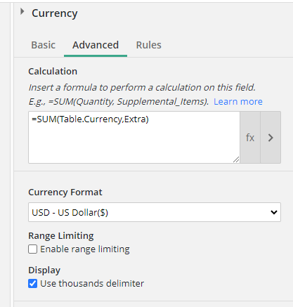

=SUM(Table.Currency,Extra) calculation on the Total field.
With some additional testing, if the Total field is not read-only it works as expected. However, we need the Total field to be read-only in our process.
replied on March 28, 2024 • Show version history
What if you use a field rule to disable the "Total" field instead of making it read-only?
That seems to work. Going forward, is it best practice to use field rules over properties for fields, particularly when using the modern designer?
