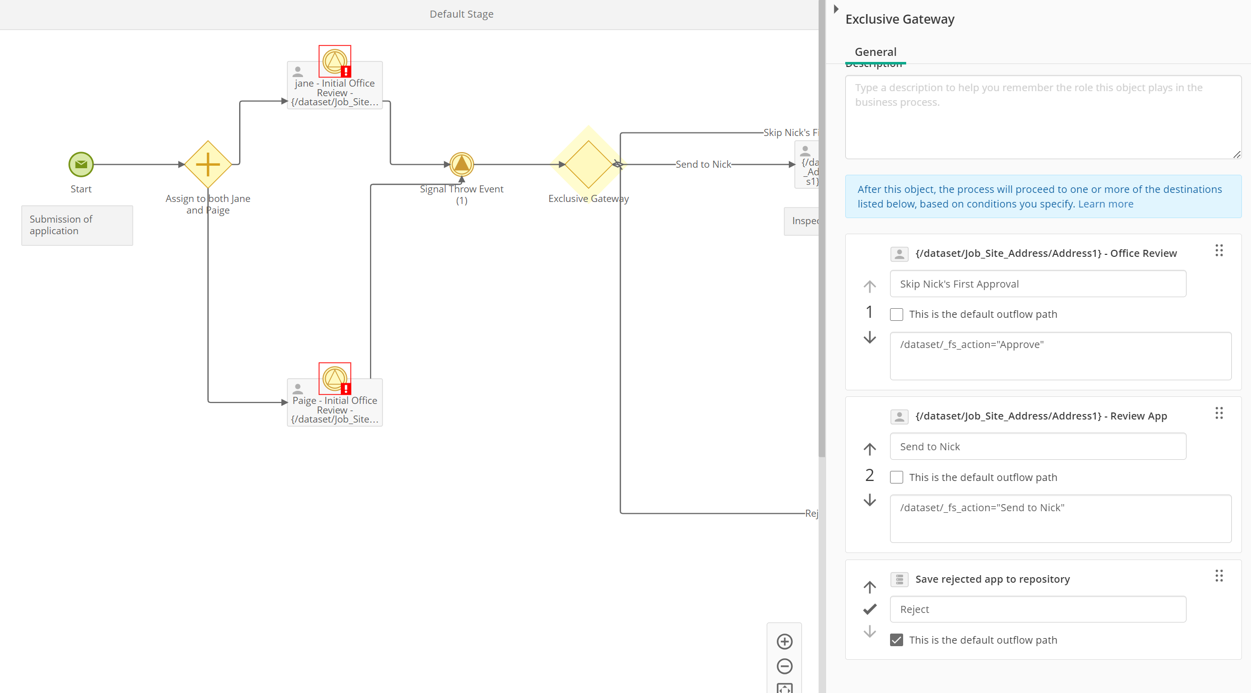

I'm working on a fairly simple Forms process. Process diagram below:
Not sure what Laserfiche thinks the problem is on the Signal Catch activities, as they're working fine. Regardless, the process terminates when it hits the Exclusive Gateway that I have selected with an "LFF5408" error - "Routing cannot be split to any subsequent branch. XPath evaluation may fail for every possible condition. [LFF5408-RoutingConditionMayFail]"
I have a default path specified, but it doesn't even take that path. What am I doing wrong here?

I might be wrong - but I don’t think it is actually the Gateway that is having the issue. I believe you need to have a path out of the two signal catch activities to tell it what to do with that particular part of the flow.  Your original screenshot shows a red box around each of those, likely for this reason.  Try adding an End Event in between those two User Tasks and running a path from each of the two Signal Catch activities to that End Event activity.  It doesn’t end the whole process, just that one path.

It looks like your signal throw sends back to the previous tasks or is there a different signal catch that is not showing?  From what I see here, it doesn't look like it would ever make it to the Exclusive Gateway.

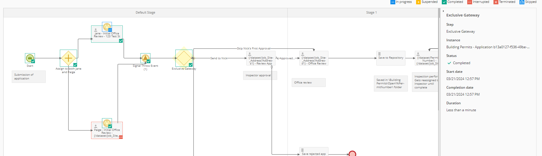

Hi Craig,
The signal throw interrupts the user task that hasn't been completed yet, which seems to be working. Screenshot of a terminated instance below:
It ends/terminates at the Exclusive Gateway.
replied on March 22, 2024 Show version history
Sharp as always, Matthew. I added an End Event and attached both Signal Catch activities to it and now it progresses as expected. Thanks!
