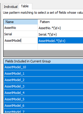

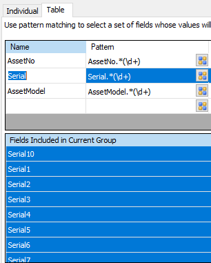

i am trying to save the form table values to PDF. I have noticed that the form line 1 appears on PDF at line 10. When i check my workflow i find the line sequence problem that the PDF line number 10 appears at top in the workflow as shown in the picture attached.

This is a variable naming convention issue. Can you not just change your naming convention to include a leading zero so it is consistent length? Example: Serial01. This would ensure Serial01-Serial09 are before Serial10.
