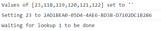

@████████, ok I tested it out. Same problem where the lookups are getting tangled up and not consistently returning all the data. One click it returns everything, another it will omit one table, another click it omits a different table, etc..
replied on March 18, 2024
Sorry for the delay, have been busy preparing for empower. Noticed your lookup chain is simpler than that JSON required, so I wrote this simpler version. The console.logs should happen sequentially if they dont let me know (cannot test)
const main = async () => {
  const triggerFieldIds = [23, 118, 119, 120, 121, 122];
  const lookupIds = [1, 2, 3, 4, 5, 6];
  const originalValues = triggerFieldIds.map((fieldId) =>
    LFForm.getFieldValues({ fieldId })
  await Promise.all(
      LFForm.setFieldValues({ fieldId, value: '' })
  console.log(`Values of ${JSON.stringify(triggerFieldIds)} set to ''`);
  for (let i = 0; i < lookupIds.length; i++) {
    const lookupId = lookupIds[i];
    const fieldId = triggerFieldIds[i];
    const value = originalValues[i];
    const handlerName = `lookup ${lookupId} Done`;
    const lookupPromise = new Promise((resolve) => {
      LFForm.onLookupDone(
          LFForm.unsubscribe('lookupDone', handlerName);
          return resolve();
        { lookupId, handlerName }
    console.log(`Setting ${fieldId} to ${value}`);
    await LFForm.setFieldValues({ fieldId, value });
    console.log(`Waiting for lookup ${lookupId} to be done`);
    await lookupPromise;
void main();

    if (i === 0) {
      // on the first run we want to set the field and then wait for the lookup
    } else {
      // on subsequent runs we want to wait for the previous lookup to be done before setting the field
  await nextLookup;
void main();
replied on March 22, 2024 Show version history
I spent an hour or so tinkering around with both of those blocks of code. Thanks again for whipping them up. I can get it this far but then it isn't putting the value back in:
So I hardcoded the fieldId and value and then it was getting stuck on 'lookupPromiseFunc' (lookupPromise in upper code).
I made a copy of the process and deleted everything but this one form. If you could email me, I'll send that over. You've been flying blind on this thing and it's real, real close :) Thanks again!
