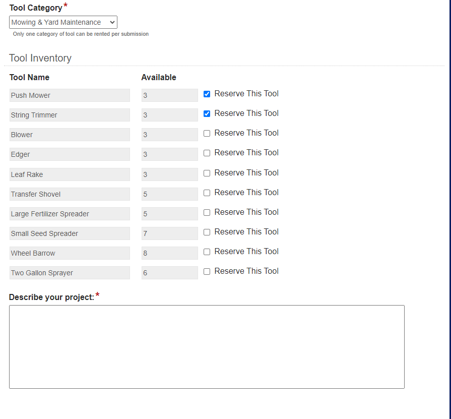

I am struggling with this one a bit because my javascript skills are lacking.
Essentially I have a form that I do not want submitted, if a citizen does not select a tool to rent.  Making the checkbox a required field won't work as some will be unchecked always.
My current JS hides the submit button quite well, but does not unhide it after the DB lookups (for current inventory)
.toolInventory is the table
.checkMe is the checkboxes themselves
    $('.Submit').hide();
    $('.toolInventory .checkMe').click(function () {
        var anyChecked = false;
        $('.toolInventory .checkMe').each(function() {
            if ($(this).is(':checked') && $(this).val() === 'Check_Out') {
                anyChecked = true;
                return false; // Exit early if any checkbox is slected
        if (anyChecked) {
            $('.Submit').show();
        } else {
What it currently does:
I appreciate any insight/advice.  My backup plan is to have the workflow determine if no values were selected, and then dump the process.  But that just seems unnecessary if I can control it from the front end.
Thank you.

You're really close - you're actually just missing one word in your code.
Side note - you can use the "{...} code" button in this editor to make your code easier to read.
        $('.toolInventory .checkMe input').each(function() {
                anyChecked = true;
        if (anyChecked) {
        } else {
The only change I made to your code was on line 6 - I added the word "input".
If you examine the structure of the fields within your form, you'll see that the fields are actually a div element which contains a lot of other components such as labels, error containers, text above and below the field, etc.  The class name (in this case checkMe) is applied to that top-level div element.  We need to find and focus specifically on the input element(s) within the checkMe div, not on the div itself.
Hope this helps, and have a good day!
