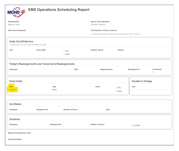

I have a form with multiple collections to which I added CSS to have clear borders around each collection so that the PDF is easier to read. The problem I am running into is that the pdf will show "Choice 1" instead of the selected value for the "Unit" field in the "Extra Units" collection when an appended choice is selected. The "Unit" field has a look-up rule associated with it and "Append choices to lookup results" is selected. Here is an example of what happens in the pdf:

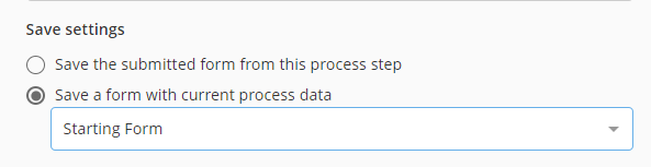

Hmm, that is interesting behavior. I'm not able to reproduce it. Can you take a look in the process diagram where you are saving the form to the repository and check the Save settings?
Which option are you using?

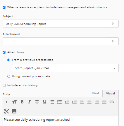

replied on February 22, 2024
The form doesn't get saved to the repository, it's being emailed as a pdf attachment by an email service task.
I checked the instance variables and it also shows as Choice 1 instead of M06 that it was selected.
