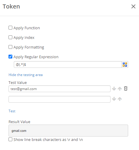

replied on February 22, 2024
Hi,
I believe if you use a regular expression in forms, it requires the user to input it the way the regular expression is set.
I can be wrong but here's my recommendation.
Pass the email address to workflow. Store the value into a token. Then modify the token and apply the regular expression. I don't know if you want to pass it back to forms or store it in SQL.
Thanks Jasciel,
This will be handy for workflow as well! At the moment I am trying to filter users from the starting form hence the need to do it in formulas, but thanks for this it definitely will come in handy!
