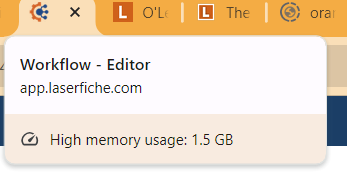

I have a workflow that has about 60 input parameters. The input parameters come from a laserfiche form. This workflow also has a document merge activity that merges those 60 input parameters to a document.
When working with the workflow (settings the variables for the merge activity) the browser response becomes very slow - it seems like there might be some background lookups... I get high memory usage in chrome and I have seen it > 5gb. I just close out and reopen and the performance is better but quickly deteriorates.
I don't mind the slowness as much as I wonder if I am pushing functional limits of input parameters and doc merge. I don't want to get to the end of this project and realize it might not work consistently.

Thank you for the sample process. We can reproduce the error, though I don't have a root cause for the memory leak yet.
