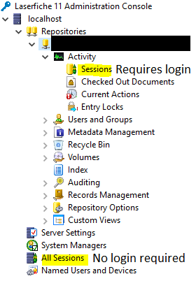

If this is an On-Prem system, you have 2 places in the LF Admin Console to look at the connections.
You can use the "All Sessions" to see and kill active sessions without logging in.

Thanks Bert,
I look at this all the time. In All Sessions, there is a column session type. I see 2 connections to a repository with my admin account. This column shows it as a "Full User" session type.
What I'm asking is why would I get this error if there are only 2 connections, and I have my admin account set up with a license. It doesn't make sense to get the error if it is a fully licensed account.
