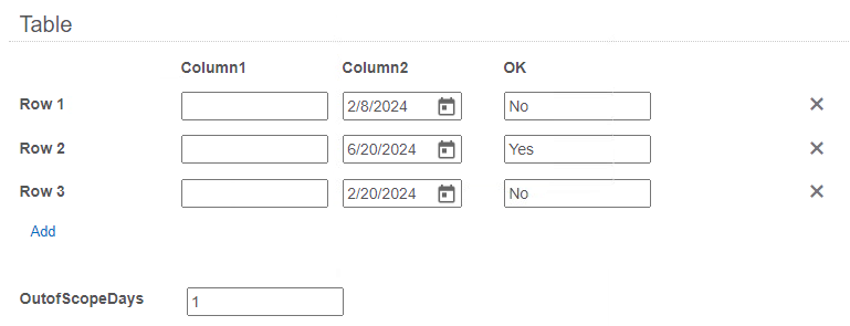

Hi Brian
See sample below
In the OK Column I have the formula that looks to see if the Date is Column 2 is greater than todays date + 90 days, If so return Yes, otherwise No
=IF(INDEX(Table_1.Column2,ROW())>(SUM(TODAY(),90)),"Yes","No")
Below, the OutofScopeDays Counts how many Yes appear in the OK Column (Column_3)
=COUNTIF(Table_1.Column3,"Yes")
You can use the OutofScopeDays in your BP condition, if OutofScopeDays >=1, then you know you as that indicates you have a day in the table out of scope.
Shoudl work in either designer
Hope this helps
replied on February 1, 2024
This worked exactly how I needed it to.
