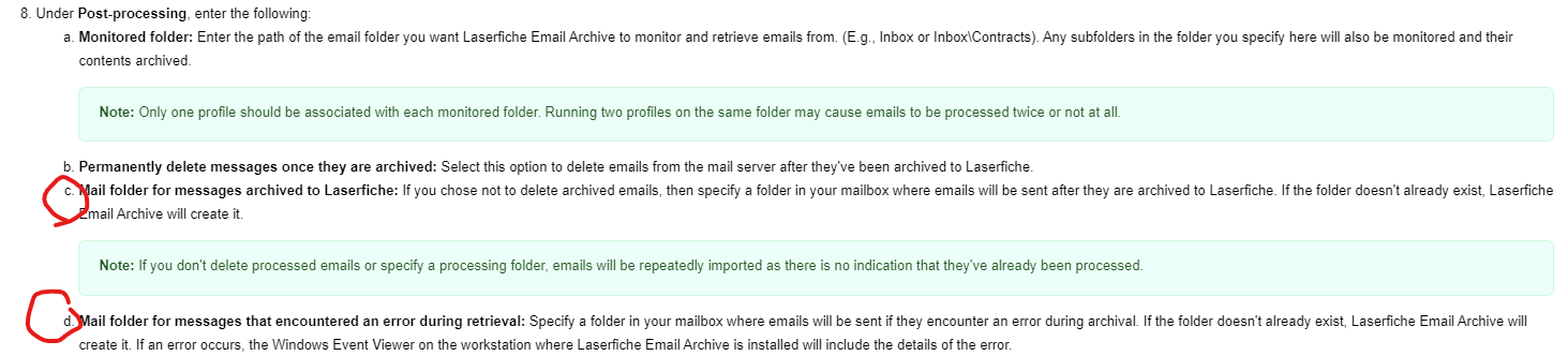

I would recommend when you configure the profile, select the following option to track what happened:
  • move the archived emails in a specified folder in the mailbox instead of deleting directly from mailbox
  • move the failed emails to a specified folder in the mailbox
see the pic:
If there are errors, it might be easier to troubleshoot through the support case with event log as Miruna said.
