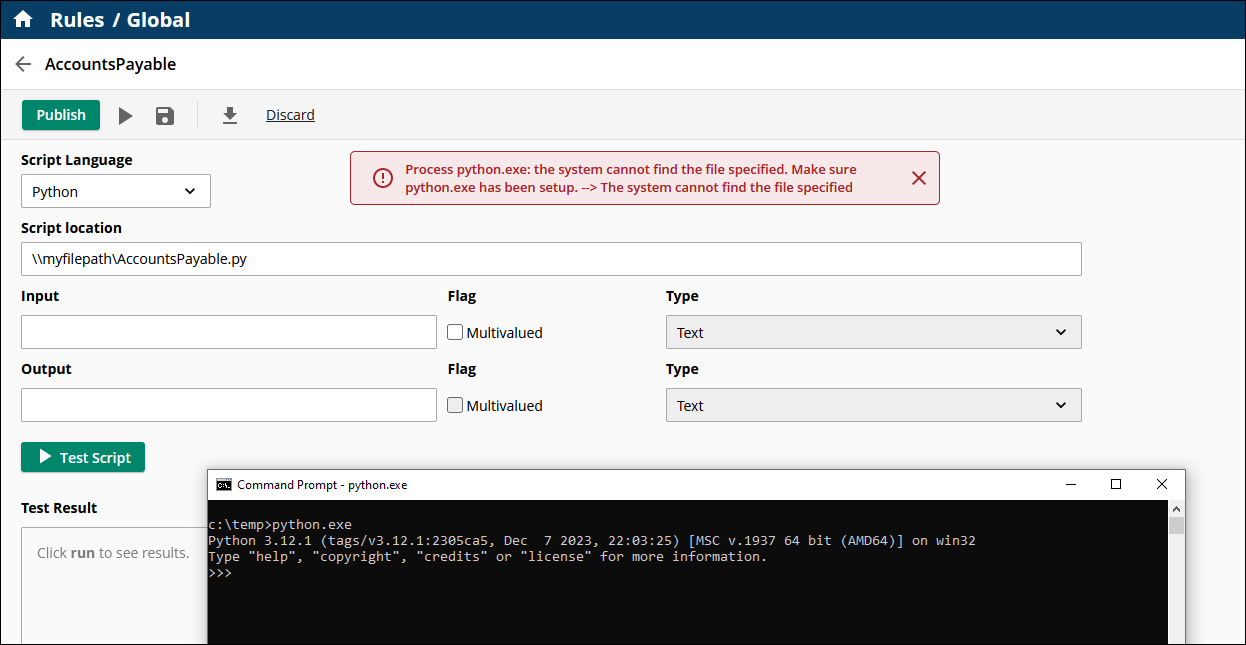

The next thing I tried was to build a python script that would create a CSV file and input data by sending it through parameters. Now I'm stuck with that as I get the following error:
" Process python.exe: the system cannot find the file specified. Make sure python.exe has been setup. --> The system cannot find the file specified"
When I run python.exe in the command line, it works just fine. I have verified the filepath, and verified that the script works (right now it's a very basic script that just creates a CSV and puts one row in without any input parameters). Why is this error happening?

I believe the Python install is per user not per machine. Is the Laserfiche Remote Worker service running as the same user as you were logged in for the screenshot above?
replied on February 6, 2024
I ended up installing Python on a separate local server. I received the same error as before, even though Python was installed for all users. After I restarted the server however, it worked. Anytime I changed the path in the LFPA config file, it didn't take effect until I restarted the server again, which seemed to be the problem. I imagine I could get away with just restarting the service, but the script is executing now.
