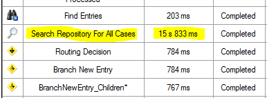

The folder move is not what is taking time.   When it goes to move the folder it is only a few 100 milliseconds.    What is taking the time is the query to search the entire repository to see if that folder already exists.   That is showing in the workflow at 15+ seconds.   Thanks!

Sure.... the workflow is designed to take a folder from one area and move it to another.   So what is does is.
Search Entire Directory to see if a folder with the same name exists.
YES:   Merge the data into the prexisting folder.
NO:    Create a new folder in the target destination.
That is pretty much it.
Here is the search query
{[]:[Case Number]="*"} & {LF:Name="%(CaseNumber)", Type="F"} & ({LF:LOOKIN="digital-evidence\1. PROCESSED DIGITAL EVIDENCE"} | {LF:LOOKIN="digital-evidence\2. DISCOVERY OPEN - CA"} | {LF:LOOKIN="digital-evidence\3. ATN RETURNED"} | {LF:LOOKIN="digital-evidence\4. ARCHIVE"} | {LF:LOOKIN="digital-evidence\2. DISCOVERY OPEN - DA"} | {LF:LOOKIN="digital-evidence\5. PURGE"} | {LF:LOOKIN="digital-evidence\6. REMOVED FILES"})
Here is the activity from the Workflow.
