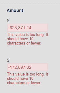

We have a currency field in Forms and just had someone try to enter a negative value of over 100,000.00. It gives the error "This value is too long. It should have 10 characters or fewer". It counts all of the - , . characters in the 10, so we can't have users enter anything over -99,999.99. If we disable showing the thousands delimiter we gain a digit.
Is there a reason why the currency field is restricted to 10 characters?

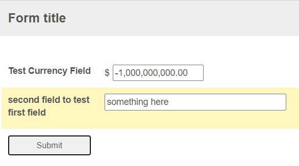

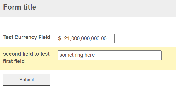

I'm not getting that error on my side and we are on the same version:

replied on January 26, 2024
Katy, I found your results interesting, so I created a new process and recreated the table and fields in the table, and I do not receive the same error message when adding more than 10 characters, so now I'm confused on what is causing this error. It is a built-in error and not a custom error, so I don't know it was from a previous version that was carried forward. This process is a few years old.
