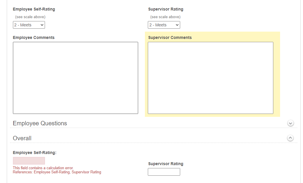

I was wondering if anyone has ever done a calculation based off of multiple drop down boxes?
I am trying to create an employee evalution form, and there are multiple sections where the employee and supervisor need to "select" a number based on a scale 0-6.
there are a total of 6 different drop downs, so I would like to sum up what was selected and put the final "total" in a Overall box at the bottom. I made it so that each drop down choice has a value assigned to it....but I am not able to figure out how to get that value to total in the other box.  Any insight would be great.

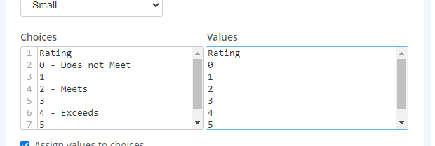

The picture is showing an example where I would like the Employee Rating (2-Meets) will SUM in the Overall Employee Rating box. Also the other one is how I have my drop down setup.
replied on January 24, 2024
Can you show what you are using for your field calculation?
My first try was the simple =SUM(employee_focus + employee_peer)  etc... with no luck
My Overall "fields" are number so they should be able to do calculations
I was a loss on where to actual do the addition w/ the values vs. just the choice.

Since your values are not a number field, it may also help to convert them to number values as well:
=SUM(VALUE(value1), VALUE(value2))
I would also advise against using "Rating" as some kind of placeholder option in the dropdown since it is not a valid option or value.
replied on January 25, 2024
So here is the new test I tried....
=SUM(VALUE(Employee_CustomerFocus), VALUE(Employee_Funtional), VALUE(Employee_Quality), VALUE(Employee_Productive), VALUE(Employee_Peer), VALUE(Employee_Action))
And still getting a calculation error.

I also did remove the "rating" option from the drop down so it all numbers. I also removed the "values" from the drop down...
