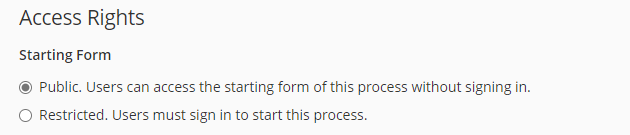

You do have the Public option checked in the Access Rights section?

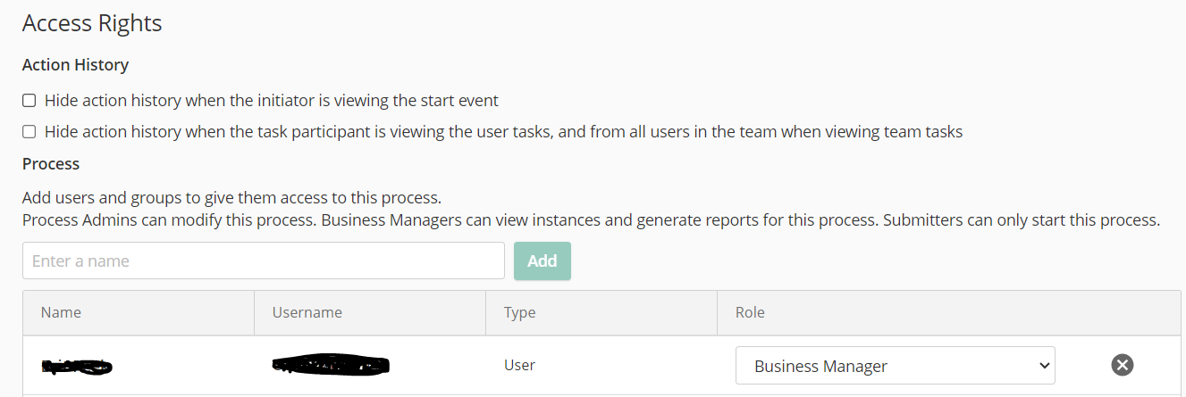

That is on Cloud-Based LF; our organization uses self-hosted, which doesn't have that option.
Attached is a screenshot of what I see on the Access Rights tab.

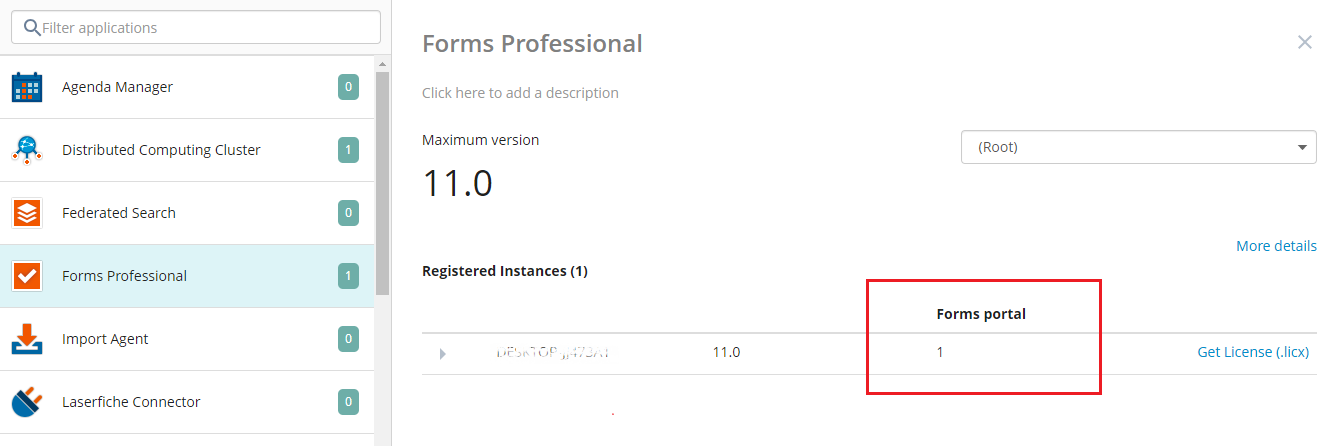

replied on January 18, 2024
@Carlos Perez Vargas
The option (Public or Restricted) is applicable on self-hosted as well if you have the Forms Portal license.
As you have two Forms installed, try to check on LFDS if you have license on the public or internal Forms.
