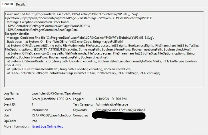

Where things get interesting is with the attached error.  There are many of these errors in the Event Viewer, and I was able to generate more by trying to preview documents that I know had been previously previewed only a few days ago.  For some reason they're typed as Information and not and Error or Warning, but the messages seem to correspond to LDPS trying to access a previously cached SVG file but it's no longer in the Cache folder.
What's not so clear is why SVG files are going missing from this folder.  Could we be bumping into one of the settings like CacheDirectoryLimit?  If it's part of normal LDPS cache operation and cleanup, then wouldn't the database be updated accordingly so it didn't think a file was still in the cache?
There are two really old SVG files from 11/24/2020 and 11/25/2020 in that folder, but the rest are from 2/16/2021 and on, which is a pretty big gap.  Does cache cleanup focus on oldest files first?

That's interesting information. The cleanup operation will remove the cache information from the sqlite database before deleting the files, so LDPS shouldn't be creating this situation itself. And it would be surprising if another application was going into this folder and deleting files, but AV or similar systems sometimes do surprising things.
I think the way we could improve LFDS would be to verify that the cached files are indeed present when the database indicates that the document is cached. I don't think it performs this check, and it seems like an easy remedy. I've filed a story to add this, it's story #504627. You can open a support case if you want to track its progress. We are in the process of releasing a web client update, which unfortunately won't include this, so the support case is also how we would give you a fix before it is included in an official release.
