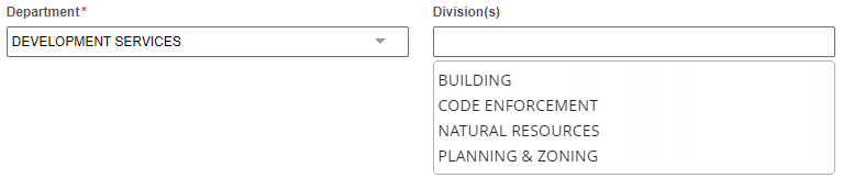

I'd like the ability to populate Checkbox and Radio Button choices from a lookup, especially now that we can view both field types as drop-downs (Amazing feature!). For my specific case, I have a drop-down from a lookup to select the Department. I then have a single line with matching Divisions suggested from the same lookup table. Users have to manually type each division if they want to add multiple.

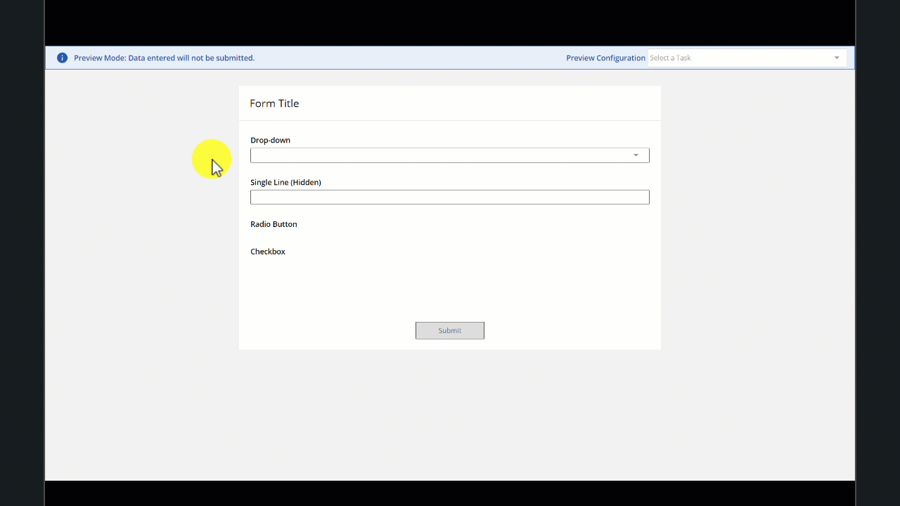

Ahh ok. I misread that...But I took a crack at it anyway. Would this work? This is the modern designer using the LFForm object.
replied on January 8, 2024
Are those options hardmapped in the JavaScript? I was looking to use a Lookup Rule to fill the check/radio options from SQL. Unless I can do a lookup into a dropdown or single line, then use LFForm to getFieldValues and then setFieldValues? It's something else to try, at least.
Yes this is using a lookup rule. And just to reiterate, this is the modern designer.
There are 4 fields on this test form,
-Drop Down for Department (ID 1)
-Single Line (to duplicate the department // hidden // acts as criteria to load data against (ID 2)
-Radio Button for Divisions (ID 3)
-Checkbox for Divisions (ID 4)
*I kept both the Radio and checkbox in the test form so you could see it works for both - you will likely settle on one of the other.

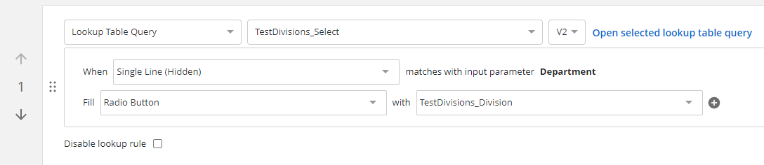

I created lookup rule(s) one for the radio and one for the checkbox. They are sourcing from the identical query and table. (You will only need one or the other).
The lookup rule looks to the hidden field for criteria to SELECT from the table.
And here is the LFForm code. I just needed to subscribe to the onFieldChange for  fieldId 1. And each time that field changes, it sets the value of the hidden field to the selected Department. When the Department updates in the hidden field, the lookup query fires.
LFForm.onFieldChange(() => LFForm.setFieldValues({fieldId: 2}, LFForm.getFieldValues({fieldId:1})),
                   {fieldId: 1});

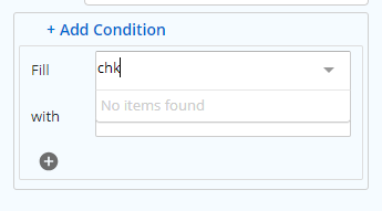

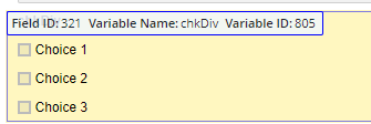

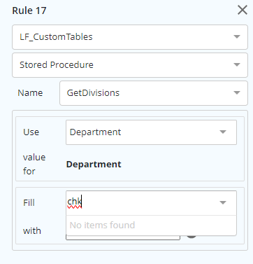

It doesn't make sense. I can't select any check or radio field in the Fill portion of the query. However, I have no problem using a dropdown as a condition.
I even recreated the SQL View I'm using into a Stored Procedure, since it looks like that's what you're using, and get the same outcome. Department below is the dropdown.
