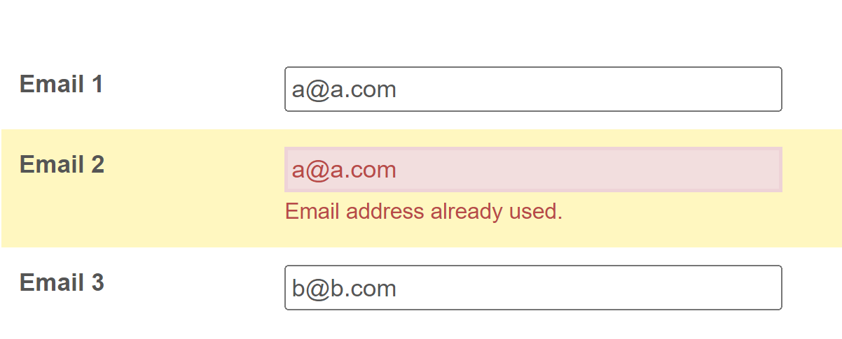

If you are able to use custom validation rules in a classic form, you can leverage the built-in validation to both show the error message and prevent submission.
In the following example (classic designer), each field with the uniqueemail class will have the validator assigned to require uniqueness, which makes it pretty easy to scale because you only need to add the class to each field.

There's a lot of different ways you could handle the actual comparison, but this is a quick example of how the custom validator approach could work.
A little more code would be needed if you're dealing with tables/collections and some of the email fields may be added after the form has already loaded.
