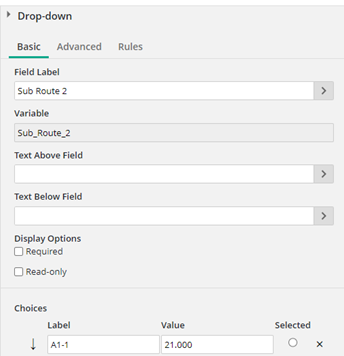

Hello, I am hoping someone can help me out with a formula. I want a value of another field to appear whenever a choice in a check box is selected. We want the value to be the same no matter which choice is selected or if multiple choices are selected but if no choice is selected, we want a “0” to appear. For example when they select choice 1 and choice 2 in the checkbox, the value in the total field will equal the value selected of the Sub Route 2 field.

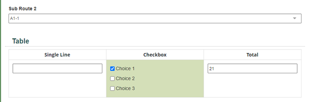

When I use a single IF formula for only one of the choices, it works and returns a value of 21 which is what I want:
=IF(Table.Checkbox.Choice_1=TRUE,Sub_Route_2,0)

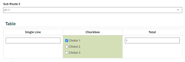

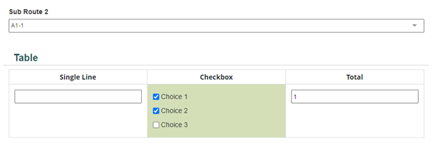

But when I try and do multiple IF formulas in conjunction with the OR formula, it returns a value of “1”:
=OR(IF(Table.Checkbox.Choice_1=TRUE,Sub_Route_2,0),OR(IF(Table.Checkbox.Choice_2=TRUE,Sub_Route_2,0),OR(IF(Table.Checkbox.Choice_3=TRUE,Sub_Route_2,0))))
