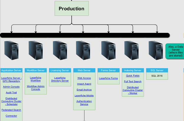

We are going to be migrating our Rio On-Prem system servers to the cloud (Azure) soon.
Our system is spread out between several servers (see attachment) and we are going to be keeping them all separate in the cloud, just as they are on-prem.
The only difference we can think of will that will occur will be related to IP Addresses. Can you think of anything else that might be different?
Are there any changes that I should be making in any of the LF applications to accommodate a seamless migration?
Are there any tips as far as what order (or all at once?) to do the servers in?
Any insight is greatly appreciated!

Hi Addison,
How are you planning to migrate the servers? Move them as-in with Azure Migrate (or similar) or stand up fresh Azure VMs, re-install applications, and then move the data?

All of our current machines are VMs, and we'll be moving them as-is using Azure Migrate (no re-installs needed). We expect it to be pretty easy, the only thing we can think of that will be different will be IP addresses, and we just weren't sure if LF used IP addresses in any sort of way that we'd have to consider.

Only if you hardcoded IP addresses in any of your Laserfiche configurations, for example as an SMTP email server address. If you used hostnames in your configurations (like you should), Laserfiche follows the normal DNS resolution process to look up the IPs.
If you've used hostnames in all your configs, you shouldn't need to anything for Laserfiche other than possibly run "ipconfig /flushdns" in an Administrative Command Prompt / PowerShell session to clear out any cached DNS results from before the migration.
Have you selected what Azure VM sizes you're going to use for each server yet?

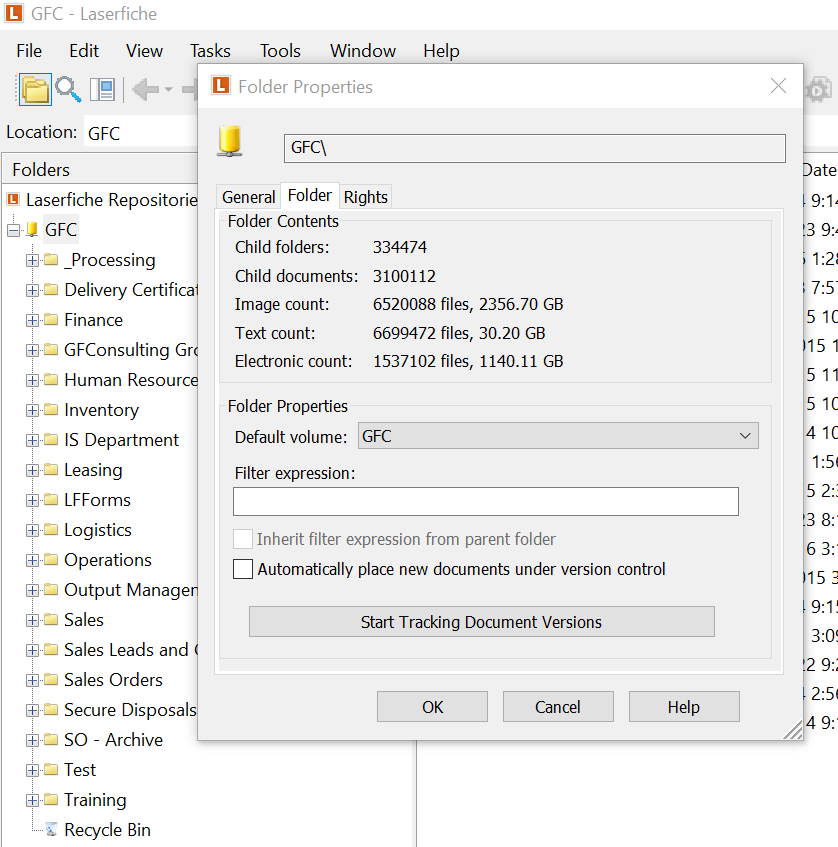

We put together a chart showing our on-prem servers and current sizing. Then we're showing the recommended Azure sizing (attached).
We're surprised to see that Azure is recommending smaller sizing for some servers than what we currently use! Curious what you at LF make of that!
For context, we work out of one repository, which is pretty massive (see screenshot), have about 100 Forms Processes, and maybe 200 workflows definitions or so. Import Agent and Email archive are used but only a few profiles in those.

Where did those Azure sizing recommendations come from? Some of them are weird. You should ignore all of the ones recommending D_v2 and F_v2 instances which are ancient at this point. Run new, cheap, burstable Bs_v2 instances instead. Don't go below 8 GB of RAM for any server.
I do see that it recommended an E8bds_v5 for your SQL Server though, which is right on point.
One important consideration that's not captured in that spreadsheet is the hardware generation of your current on-prem servers. You can easily find that by checking the CPU model(s) in the System Information dialog of Windows. It'll say something like this example from my laptop:
Processor:    11th Gen Intel(R) Core(TM) i7-1185G7 @ 3.00GHz, 1805 Mhz, 4 Core(s), 8 Logical Processor(s)
For an example of the difference a CPU generation can make for certain workloads, see: Microsoft Azure® Esv5 Virtual Machines Delivered Up to 48% Higher Microsoft SQL Server Online Transaction Processing Performance Than Esv4 Virtual Machines
