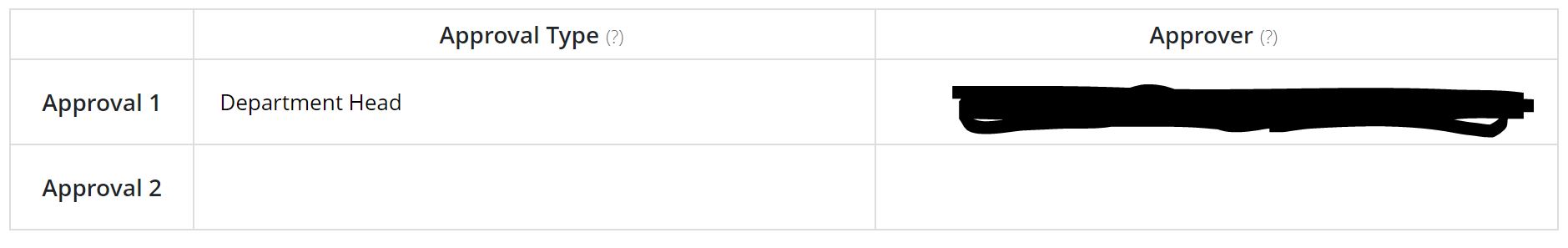

I've been using a stored procedure to dynamically establish a customized set of approvers based on organizational hierarchy.  Essentially pick whatever using a database lookup,  feed a number of fields with organizational data, and use that information to fill the stored procedures parameters, which brings back a table of the necessary approvals. The thing is the stored proc fires a lot (once at the beginning and once each change event), and overwhelms form, so I built a calculated field that tests to see if all the data needed is there and sends an Ignore parameter that returns the table with no rows, this results in a table with one blank row on the Forms side.
This works well excepting for sometimes the initial load, the timing gets befuddled and sometimes brings back and earlier request after the last change event's request.  Since he empty table always results in a blank row which is not ideal.  When the timing gets out of sync it'll append that blank row to the real  table, and sometimes when this happens, it sometimes throws a console error, something about .split() which stops the form from being able to submit.

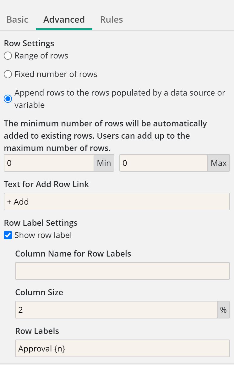

You said this doesn't always happen so the table settings seem unlikely to be a factor, but also double check the how the table is configured to handle rows.
Again, it seems unlikely based on some of the details you provided, but if the table was set to append a minimum of 1 row it could cause behavior like this.
replied on December 18, 2023
I'm not currently using any javascript in this form.   I set up my tables using the following settings which can bring in multiple rows of records without allowing users to add rows. I generally disable the visible fields as well so the table is for all intensive purposes read only.
