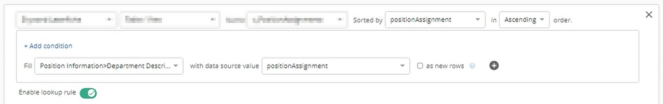

Hi Blake,
If my understanding is correct, when you populate the "Employee's Name" field, first you want the table to populate rows with "HAADSC-DESC", and in the dropdown list, the options comes from "positionAssignment". I can make this work with Layout designer
Compare with classic designer
As you can see, the rules are defined same, and after input 'form' in the single line, I get the same list of IDs, with an extra "forms" option which is from the Last Name column

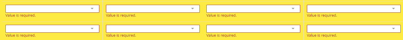

I just tested this in 11 Update 5 and it works until I get to the rules for the 4th column. Below is the basis of how the rules for all 4 columns are configured.
When I add the 2 rules for the Level 4 Approver, it only populates the first row. If I disable the rules for the Level 4 Approver it works as expected.
UPDATE: Doing some additional testing with the Level 4 rules disabled, I occasionally get rows back where rows are created, but all 4 column values are empty.
