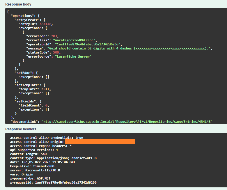

I am attempting to upload a pdf document to our Laserfiche repository via the self-hosted API.
specifically: POST.../Entries/{Parent ID}/{document name} returns a 203 (full error below)
I can see that it Does create a file in the appropriate repository and directory, with the appropriate name and metadata from my request body, however, when I try to view it, it says "this document contains no pages" under Image, and "this document does not contain an electronic file" under Electronic File.

Other API calls work fine. This error appears whether I am using swagger or my own program.

It's hard to tell what causing the error just from the response. Could you also share what's the request body and headers look like?
Could you also try upload a file with our sample project with self host configuration to see if it also get the error? https://github.com/Laserfiche/lf-sample-repository-api-dotnet-srv/tree/v1#self-hosted-prerequisites
There is a ImportDocument method that would upload a document to the sample project folder. https://github.com/Laserfiche/lf-sample-repository-api-dotnet-srv/blob/v1/Program.cs#L54

thank you for your response!
yes, i ended up just using the sample project, whose document upload methods work.
the server still throws the above GUID error, but it turns out that it doesn't stop the document from being uploaded. i must have been doing something else wrong, and that error sent me on a goose chase.
