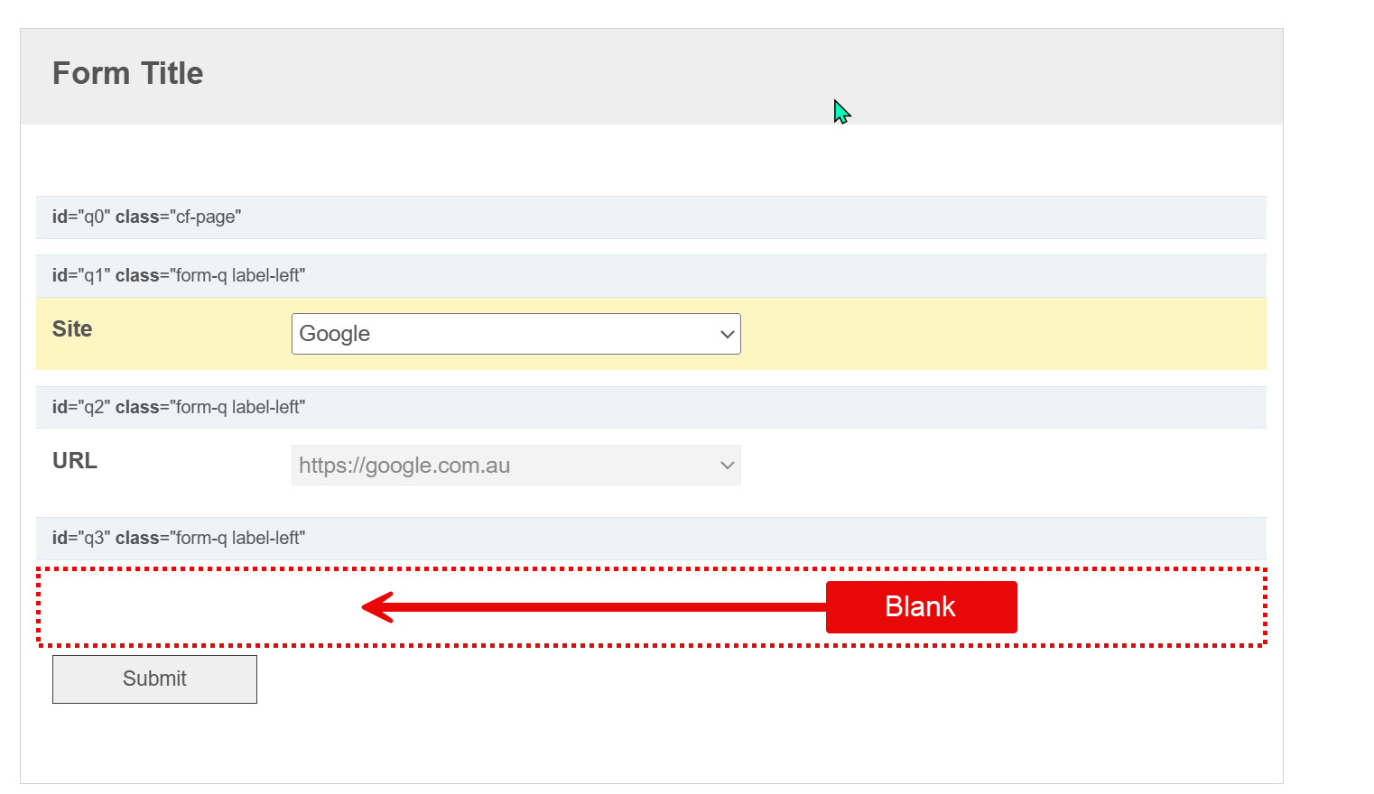

I think there was a referencing issue with this example code.  Q1 is the selection, the url is returned to q2. When Q1 is changed we want to pick up the value in q2 and create a href called newHtml and for that to display in the custom HTML.
1. Q3 is not being populated, it is blank
2. console.log are not creating log entries in the f12 tools

  $('#q1').on('change', 'input', function() {
    // Get the URL from #q2
    var clickablelink = $('#q2 input').val();
    // Write URL value to console
    console.log("#q2: " + clickablelink);
    if (clickablelink.length !== 0) {
      // Reset HTML code and replace href
      var html = ('<a href="clickablelink" target="_blank">linkdescription</a>').replace(/clickablelink/, clickablelink);
      // Replace link description
      var newHtml = html.replace(/linkdescription/, clickablelink);
      // Set value of q3 to newHtml
      $('#q3').html (newHtml);
      // Write #q2 html to console
      console.log("#q2: " + $('#q2').html());
replied on December 5, 2023 • Show version history
