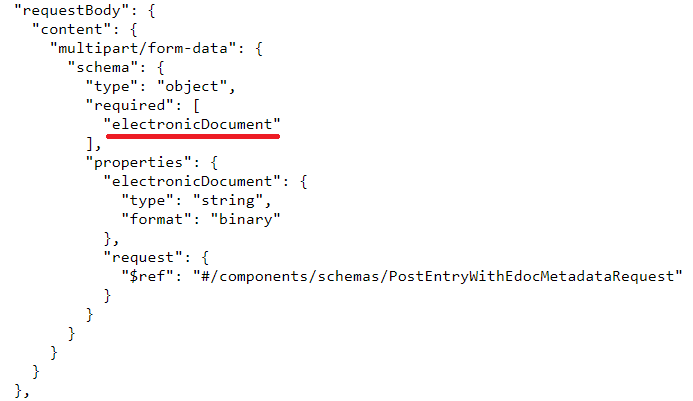

Hi,
In v1, the name of the property in the request body is "electronicDocument", not "file", as mentioned in the swagger schema.
replied on November 28, 2023
Thanks Samad, that's great! The customer are using a .NET application to make the request, and they're using the below method.
Dim stream = New MemoryStream(file (byte array))
.Net.Http.MultipartFormDataContent.Add (New StreamContent(stream), "electronicdocument", fileName)
Is this the recommended approach for adding the form data to the request?
Cheers!
Dan
Hi,
Yes. It looks fine.
