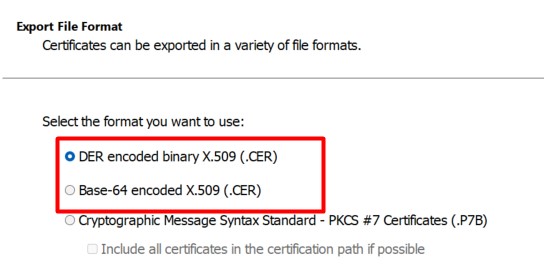

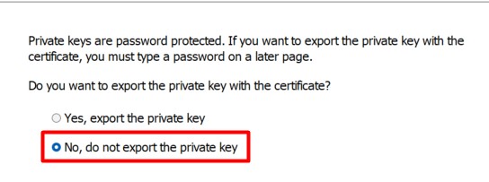

i havent tried it yet @ my client, but it depends whether you are using a self-signed or a proper certificate.
for self sign, when exporting the certificate from "MMC\Certificates", you select "No, do not export the private key", then you have options for x.509 on the next screen.  Once done, this will be the certificate to be installed on client PCs.
I am not an expert on that side though, may be someone else can assist.

replied on November 23, 2023
Hi Dilshaad,
Your suggestion did not work. The same problem occurred.

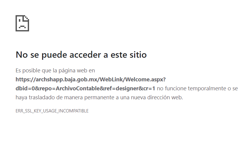

replied on November 22, 2023
i have the same problem. ¿Any idea?
Using Chrome with https it does not works :(
I have no idea also how to resolved this issue.
