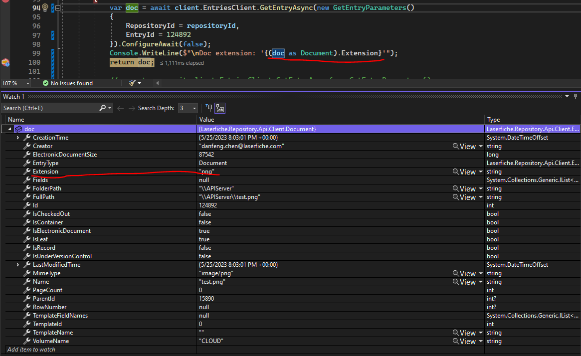

Hi,
There is no need to use "Select". If the entry type is Document, it would automatically get the extension. You just need to do a type conversion to Document and get it. Please see the following code for how to do it.
When using select, only the selected properties would return in response. And it seems that our client has issue converting the response to the Entry data type in that case. We will look into the issue and fix it soon.
replied on November 17, 2023
If you do want to use Select, the workaround for now is to also include entryType like
var doc = await client.EntriesClient.GetEntryAsync(new GetEntryParameters()
    RepositoryId = repositoryId,
    EntryId = 124892,
    Select = "entryType,extension"
}).ConfigureAwait(false);
