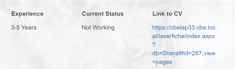

I have a link that populate on my forms directly from my Repository. I want to change the link name on forms and display Click Here instead of the whole link. Can you help me please? Thanks.
replied on November 16, 2023

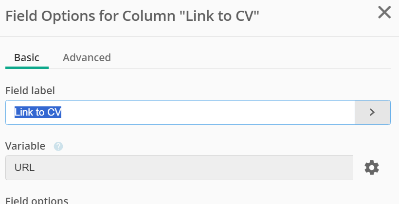

You would need to use a Custom HTML field for that. It looks like your screen shot is of a table. If that is the case, you could keep the Link to CV column, but hide it and add a Custom HTML field that creates the link. Something like this:
<a href="LinktoCVVariable">Click Here</a>
Replace the LinktoCVVariable with the actual variable from Forms.

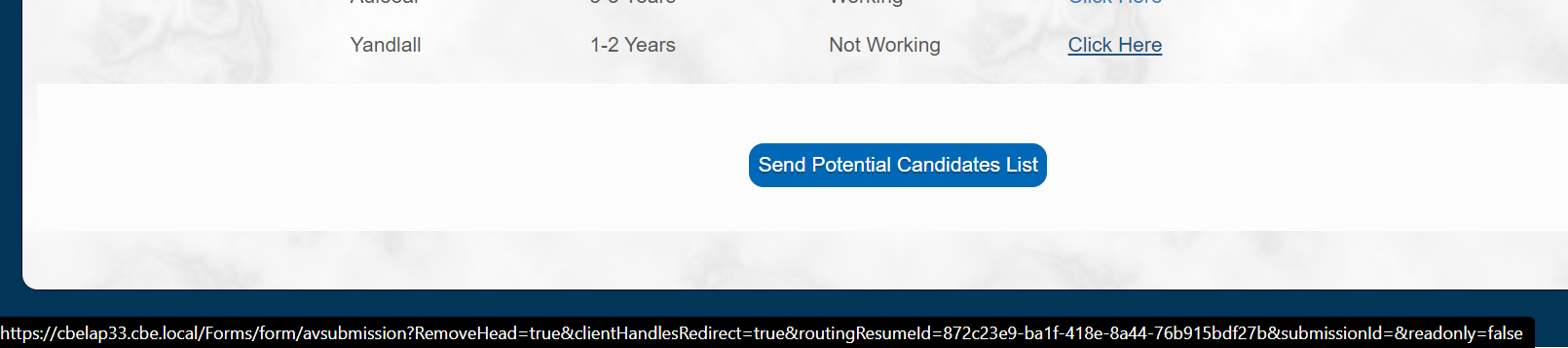

Look at the link shown below at the bottom of the page
It directs me to the form again.
I have used a javascript and it sends me back to the form again
Look at the link at the bottom of the page
$(document).ready(function(){
  $('.link [type="text"]').each(function(e, el){
    var link = $(el).val();
    $(el).replaceWith($('<a href="' + link + '" target="_blank">Click Here</a>'));
