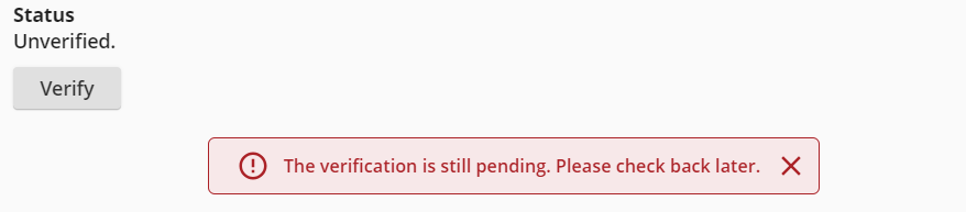

asked on November 15, 2023
Any ideas as to why we cannot verify a connection to a DB in the Cloud data source menu?

replied on November 15, 2023
Thanks Kevin,
This is the only error we get in the logs:
Message: A network-related or instance-specific error occurred while establishing a connection to SQL Server. The server was not found or was not accessible. Verify that the instance name is correct and that SQL Server is configured to allow remote connections. (provider: TCP Provider, error: 0 - The remote computer refused the network connection.)
I have verified the instance and I have made sure I can log into the Management Studio using the username and password.
