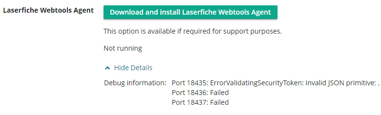

Is there a whitepaper or article detailing the specific ports or protocols required to send the data using the Scanning Tool? When using the Web Client outside of our network, it doesn't recognize that its there and requests that it be installed again.
An example of the error we see in the Web Client is attached as well.

Web Tools Agent only uses https/443 to communicate with the remote web client server. What you see there is the html page running in the browser attempting to communicate with the Web Tools Agent running on the local machine. This is the mechanism it uses to e.g. launch the scanning application. Those are the 3 ports that it will attempt to use. It sounds like your machines are set to use different firewall rules when attached to different networks, and you'll need to update those. But note that this is kind of an unusual connection as it's between processes on the same machine - you don't need to allow remote requests on those ports, just local ones.

Brian, the Debug Information for Port 18345 "ErrorValidatingSecurityToken: Invalid JSON primitive: ..." jumped out as odd to me. That doesn't sound like a network error.
Brent, are you by any chance using a load balancer/reverse proxy with cookie-based session affinity in front of multiple Web Client instances?

I think you're right. Probably the page was able to successfully connect to the agent, but the agent was not able to connect to the web client machine.

Samuel, yes, you are correct about the following:
Brent, are you by any chance using a load balancer/reverse proxy with cookie-based session affinity in front of multiple Web Client instances?y
We feel this is probably a problem we will need to resolve on our end, but any possible solutions or helpful advice would be appreciated.
