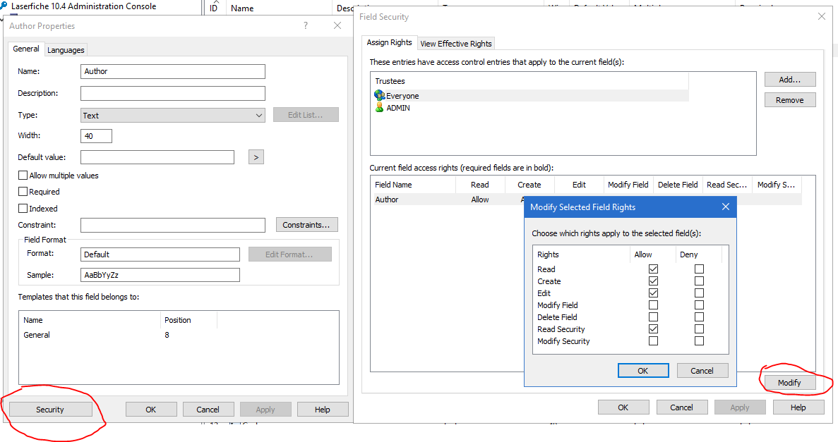

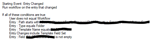

You could have a workflow kick off to change or add a "Last User Change" date field.
replied on November 16, 2023
Remember to modify the access rights to the field so that the user community cannot change the value.  Make it so the administrators (including Workflow) are the only users that can change the field.
