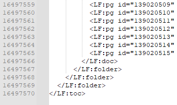

The toc XML is over 3.5Gb and notepad refuses to open it due to size. Notepad++ warns that it will take time to open as it is very large.

I've examined the headers and the footers of the xml file and they appear in tact.
